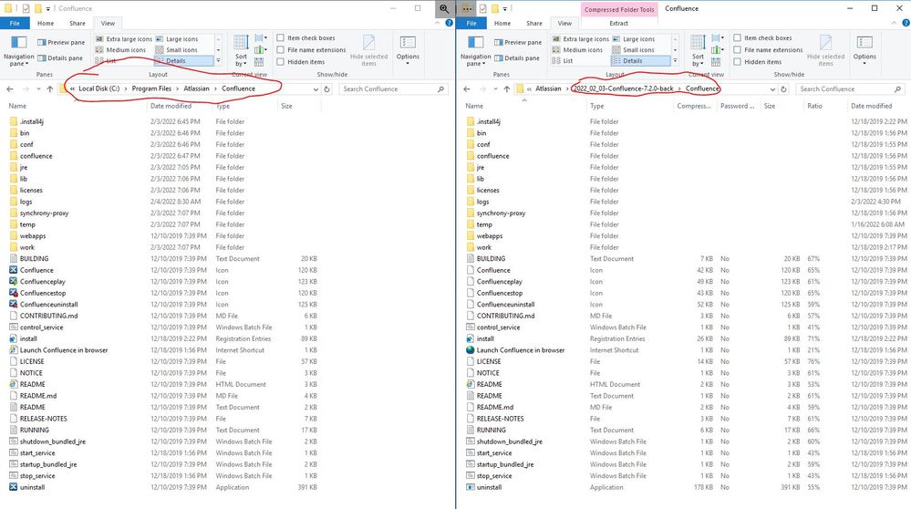

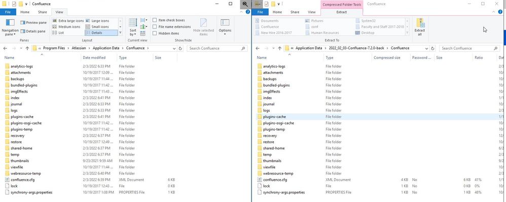

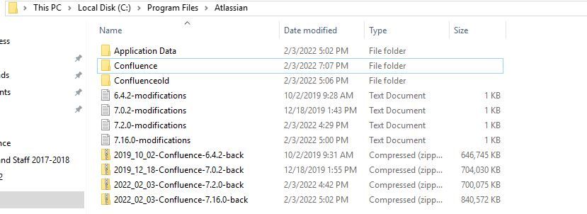

@Juan Ramirez : I need the following since I'm not the one in front of the computer:
Screenshots of:
The directory structure below C:\Program Files\Atlassian so I can verify
- The install directory
- the Confluence home directory
What the services panel looks like.
In the meantime, for when you try to do the upgrade again, here's a link to the upgrade guide: https://confluence.atlassian.com/doc/upgrading-confluence-4578.html

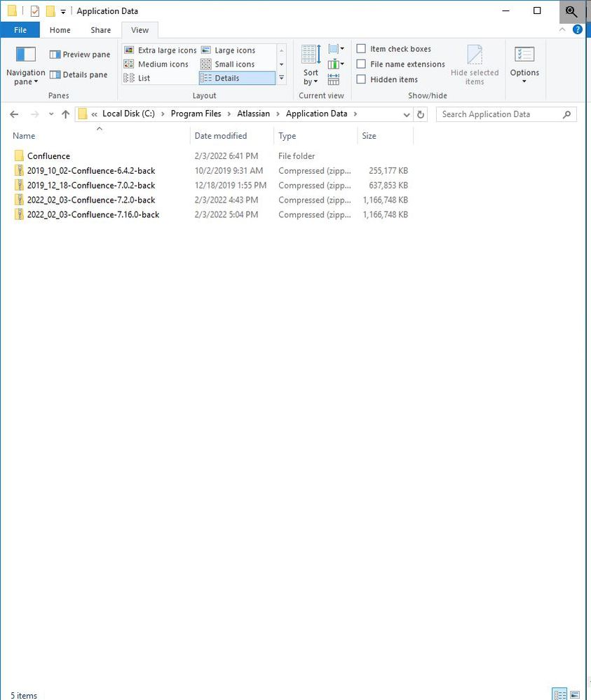

Thanks for all your help. I am including the screenshots of what I see for the install and home directory with the backup files I used to restore to each directory. I am including the service general and log on screens too.
Thanks againInstall Directory.JPGBackup and Install Directory.JPGHome directory and backup folder contents.JPGHome Directory with Backup file.JPGService General.JPGService log on.JPG

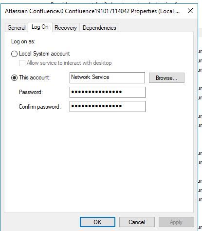

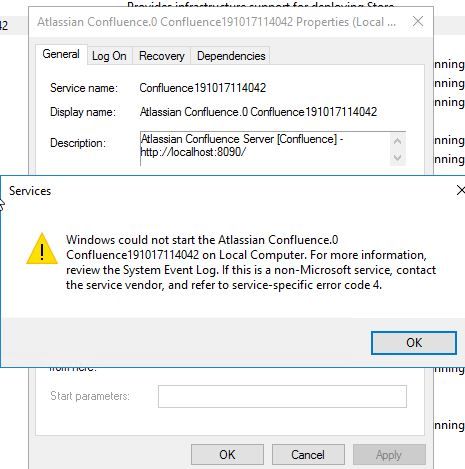

I would like to add that error message I get when I try to start the service is related to a permissions problem. The error code is 4.Error code 4.JPG
Robert Wen_Cprime_
February 4, 2022
OK
1. Copy/verify that the contents of 2022_02_03-Confluence-7.2.0-back\Confluence are in C:\Program Files\Atlassian\Confluence - That is the root level of your install directory.
2. Copy/verify that the contents of 2022_02_03-Confluence-7.2.0-back\Confluence are in C:\Program Files\Atlassian\Application Data\Confluence (basically your Confluence home directory).  The only file of importance here is confluence.cfg.xml. You want to make sure that's the original file (from 7.2). Everything else may not be touched since the upgrade broke.  But if you want to be really cautious, entire contents can work.

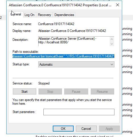

3. Start Confluence MANUALLY. Run C:\Program Files\Atlassian\Confluence\bin\start-confluence.bat
4. Once you've verified that Confluence starts up and is 7.2, stop Confluence MANUALLY. Run C:\Program Files\Atlassian\Confluence\bin\stop-confluence.bat
5. Look at the entry for the Confluence service.  Verify that the correct version of Tomcat is being called (I don't think "tomcat9.exe" is in 7.2 version of C:\Program Files\Atlassian\Confluence\bin).  Refer to the guide I posted previously for setting up Confluence as a Windows Service.
Good luck!
Juan Ramirez
February 4, 2022

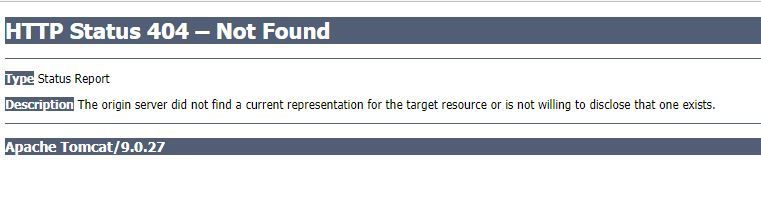

I did follow the instructions on how add manually a new service. The new service started but I get now a 404 error when I open the link for confluence. Before the 404 error, I get the  message your confluence instance is already setup. Then when I click on return to Confluence I get the 404 error below. The new service that was created manually still has the \Tomcat9.exe instead of the Tomcat9w. How do I change that parameter? Thanks,Instance is completely setup.JPG404.JPG

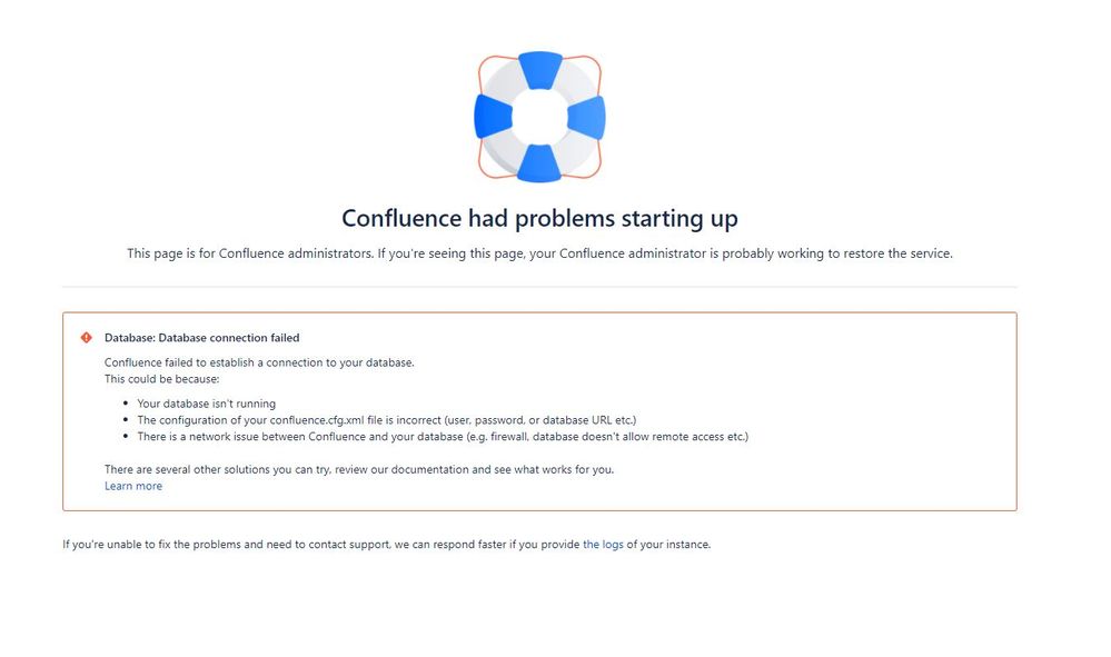

We are making progress. I restored both directories using a backup from 2 days ago. Before restoring, I renamed the old directories and restore so all files from Wednesday were copied. I started the service and it worked fine.
Now I get a database connection error from Confluence. The configuration file shows the correct sql database, path, username and password but it cannot connect. Does it mean  that the SQL database was changed when I updated to 7.16? I can restore the SQL database to a 2 days ago version.

Robert Wen_Cprime_
February 4, 2022
Yes, it looks like there were some writes to the database during the upgrade process.
Shut down Confluence.
Restore the database with the backup from 2 days ago.
Restart Confluence.
Juan Ramirez
February 4, 2022
No, it was not the database. It was TLS. I modified the Java option on the service and it worked. I did not have to restore the database.

Identify the name of the service that Confluence is installed as in Windows (Go to Control Panel > Administrative Tools > Services)
We are expecting to see a service name like this Confluence251017164028
Open the command window (Choose Start > cmd.exe)
cd to the bin directory of your Confluence installation folder and run the following command:
tomcat9w.exe //ES//%service_name%

Peter DeWitt
February 3, 2022
@Juan Ramirez This may be as simple as you configuration file not pointing to the correct JDBC driver or you are using an older non-compatible driver. Check out this compatibility matrix to ensure you are using version that play nice together:
https://confluence.atlassian.com/doc/supported-platforms-207488198.html
You can also verify that you config files are setup correctly with the aid of this article.
https://confluence.atlassian.com/doc/configuring-a-datasource-connection-937166084.html
You can also open a support request directly with Atlassian Support and they may have additional things for you to check.
-pjd
Juan Ramirez
February 4, 2022
Hi Robert,
Thanks again,Install Directory.JPGBackup and Install Directory.JPGHome directory and backup folder contents.JPGHome Directory with Backup file.JPGService General.JPGService log on.JPG
