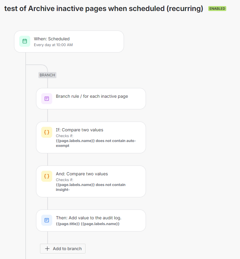

Branch 1:

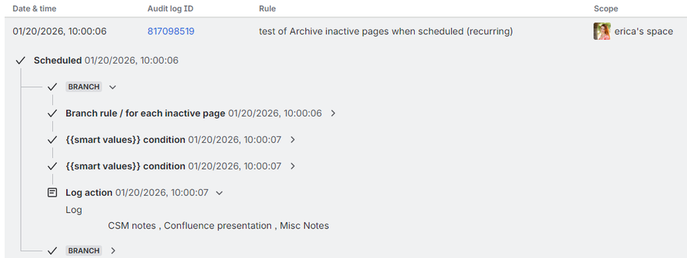

Audit log:
Branch 2:

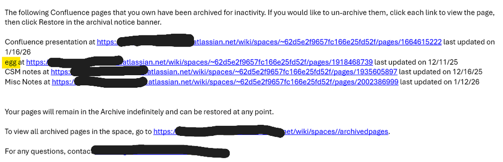

Notification email:
Notice that "egg" (my test page with one of the excluded labels) doesn't appear in the log but does appear in the notification.

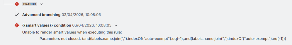

Hi @Bill Sheboy! I was finally able to test out the scripting you provided. Unfortunately, I'm getting this error:
This is what I have as the first value:
{{#varOwnerInactivePages}}{{#if(and(labels.name.join(",").indexOf("auto-exempt").eq(-1),and(labels.name.join(",").indexOf("auto-exempt").eq(-1)))}}{{title}}~~{{/}}{{/}}
Is it just missing a parentheses? How do I fix that?
