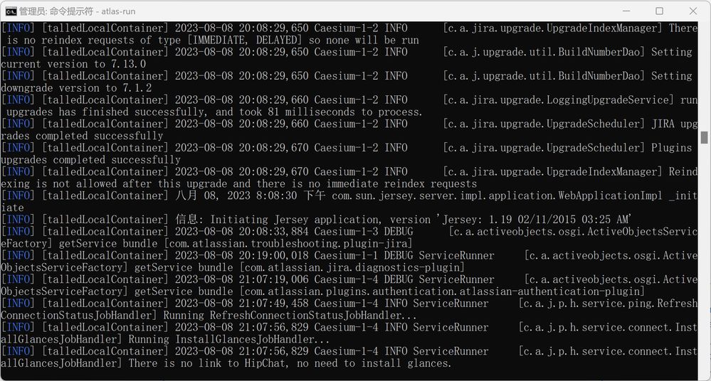

daihaiyang
August 8, 2023
mwssage : There is no link to HipChat, no need to install glances.
Nic Brough -Adaptavist-
August 8, 2023
Hipchat is an old function that Atlassian have not yet refactored out of their code base, just in case people are still using it!
The messages you have given us a tiny fraction of the logs, and do not show any errors.
Can you start by looking at the logs (you'll find this a LOT easier in a plain text editor - 32 screenshots are going to be very hard to read).  Start at the bottom and read back until you find the first actual error that occurs (you may find you have to plough through many newer errors before you reach the first).

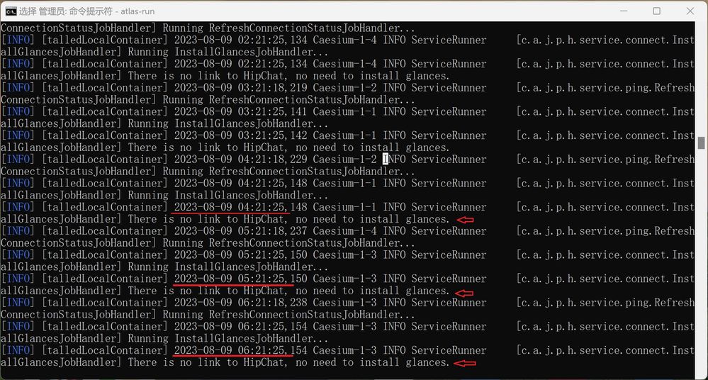

daihaiyang
August 8, 2023
When I running "atlas-run",the progress keeps repeating a certain step: there is no link to hipchat, no need to install glances.
August 8, 2023
Repeating the question will not help.  We've already told you that you need to read the logs for the actual errors.

daihaiyang
August 8, 2023
Robert Wen_Cprime_
August 8, 2023
This log is showing the same message roughly every hour.  Is this actually preventing your simulated application from running?
