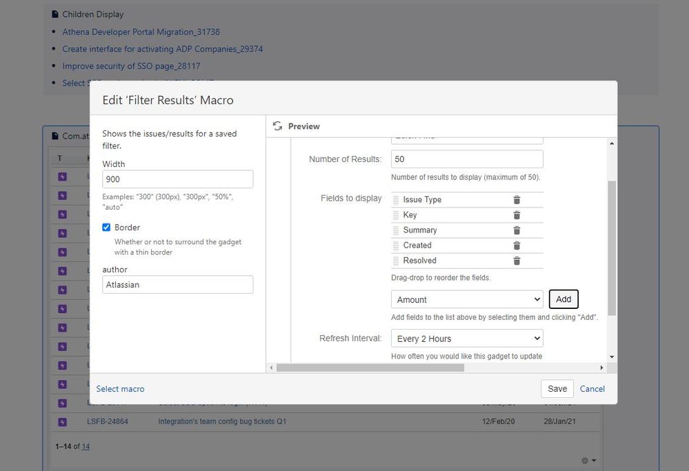

Hi:
Yesterday I added into a Confluence Page the "Filter Results" Macro.
I configured it and it was working fine.
But today, when I try to add new Fields so they can be viewed, I can't save it (It's not working)
Could You please provide assistance?
Thanks in advance!

Hello @Jose Rodriguez ,
I just had the same issue as you did. I don't know if this is still an existing issue but I managed to find a workaround for this issue and wanted to share it with you. The only way in which I managed to delete/modify/rearrange issues in the "Filter Results" macro (in confluence) was to access the "Source Editor" from the edit mode of a page, and in the code, in the "filter results" part of the code to delete/rearrange the fields in the way I wanted.
Check the screenshot to see how to find the "Source Editor".

Hello Jose,
It looks like you're running into an existing bug where the Filter results don’t work with some fields:
Please be sure to watch it, so that you are notified when this is fixed in a future release.
