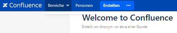

I have some problems with my fresh installed confluence.
1 - I am not able to see or create any spaces:
The drop down menu is just blank.

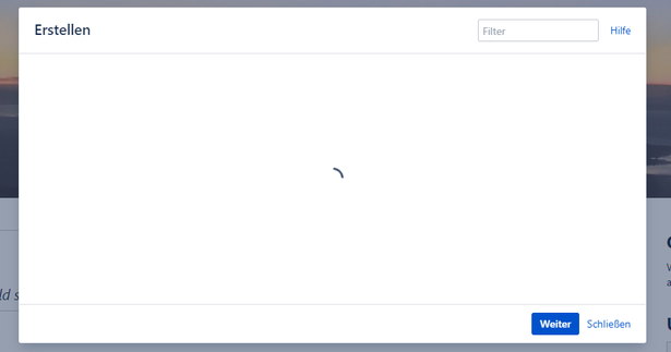

2 - When i try to create a page from a blueprint it just loads forever:
I already tried to reindex the content of the installation. Do i overlook something here?
EDIT:  Solved the problem with the latest jdbc driver. Now everything works fine.

naturwundR
October 14, 2019
Hello @Shannon S
Sure! Sorry for not posting the solution right away.
  • First i stopped confluence
  • Then I downloaded the latest jdbc driver from https://jdbc.postgresql.org/download.html (42.2.8) onto the server and placed it in /opt/atlassian/confluence/confluence/WEB-INF/lib
  • After that i just restarted confluence.
That's all! :)
Before i used the driver which was mentioned here : https://confluence.atlassian.com/doc/database-jdbc-drivers-171742.html (postgres-9.4-1202)
I just really tried the latest version of the driver because this line in the log cached my attention:
Caused by: org.postgresql.util.PSQLException: ERROR: column am.amcanorder does not exist
Position: 427
So i thought i would give another driver a try because i saw that there are newer drivers available.
