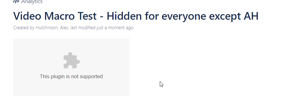

Thanks for your post. I had tried this originally but unfortunately it didn't seem to work for me.
I think its a problem with the confluence configuration or something on the back end. I also believe its related to HTML5 (through further investigation).
Is there any way I can check (Apart from the obvious test of trying to add a video to Confluence just to see what the result is) to see if HTML5 is supported within our Confluence instance.
What file formats does the multimedia app support? The videos I am trying to embed are WMV files. Should I try and convert them to a different format?
