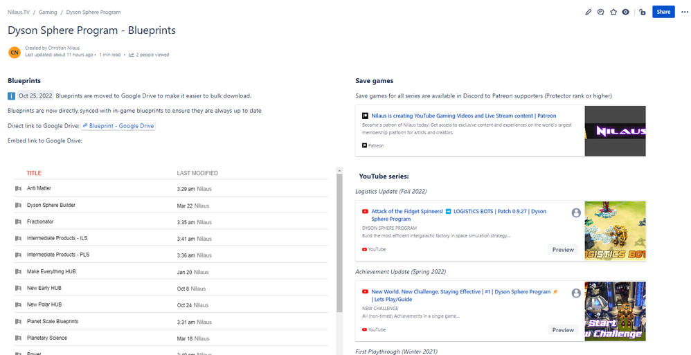

What it looks like for me:

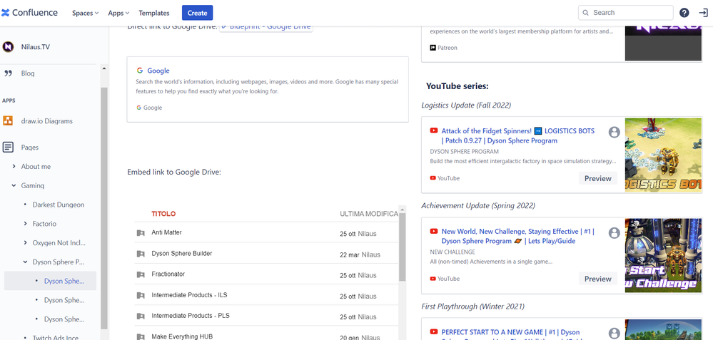

What it looks like when not logged in:

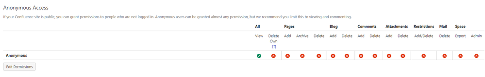

My space is set to everyone being able to view all pages:

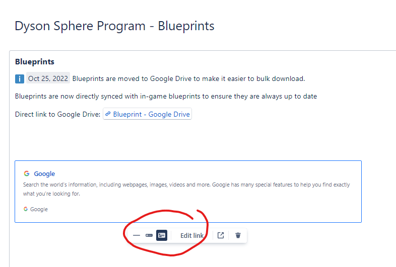

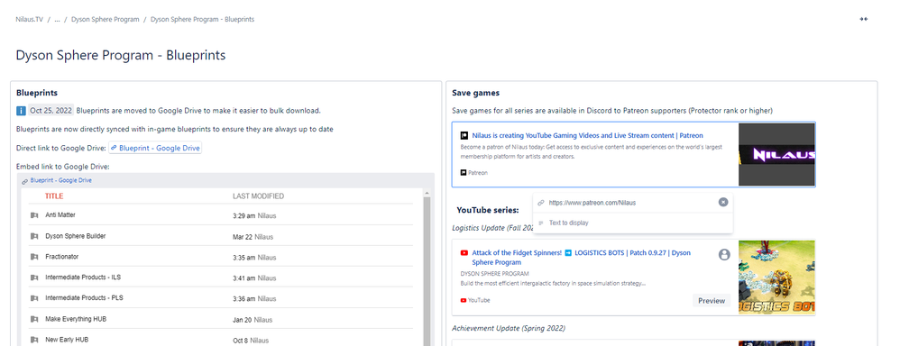

And lastly a picture in edit mode of what I try to do in case that is where the issue is:

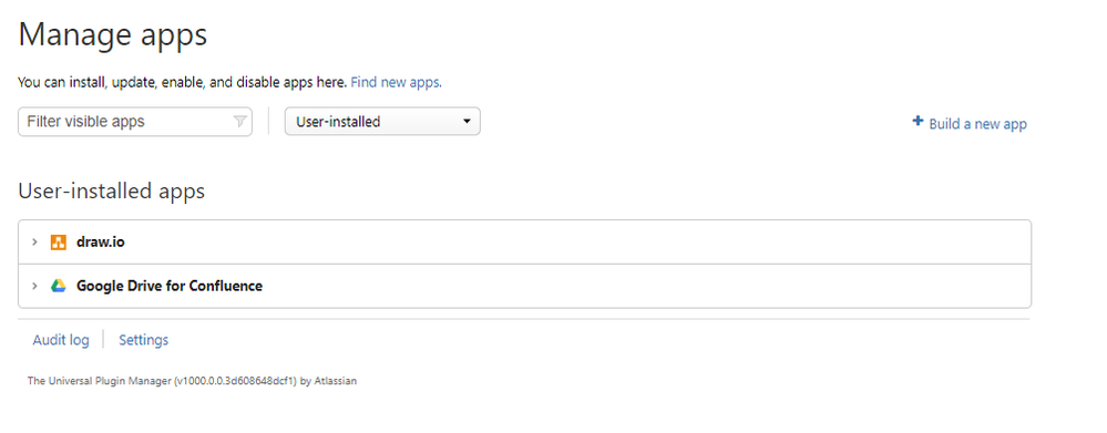

I had 2 Apps installed (didn't even realise it):

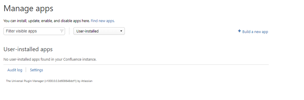

Now I have unsubscribed and uninstalled them so this is the same view for me now:
I have opened, edited and published the page again and it looks exactly the same for me as before: works when logged in, doesn't work when not logged in. It seems the "link" macro is broken for me at least

I simply write a URL in Confluence and it prompts me whether I want to display it as URL, Link, Card or (for some pages) Embed. There are no macros or third party apps. Just plain old default Confluence functionality: type a URL and it recognises it.

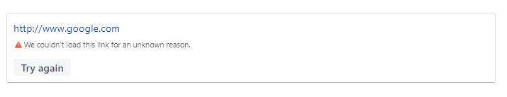

I even added a link to www.google.com to prove that no websites work
