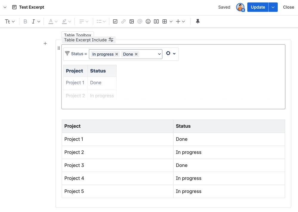

Here is the page in the Edit mode:

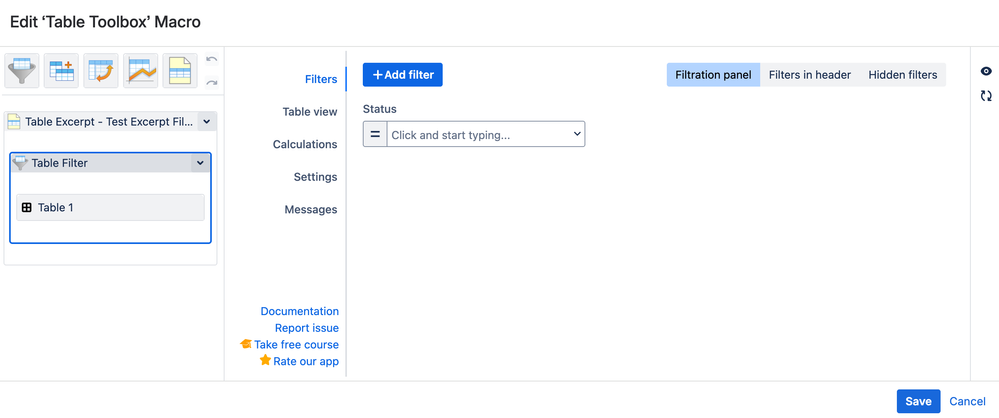

The Source Table structure is as following:
We set the dropdown filter and then reuse the filtered table (just as you do it on your screenshots).

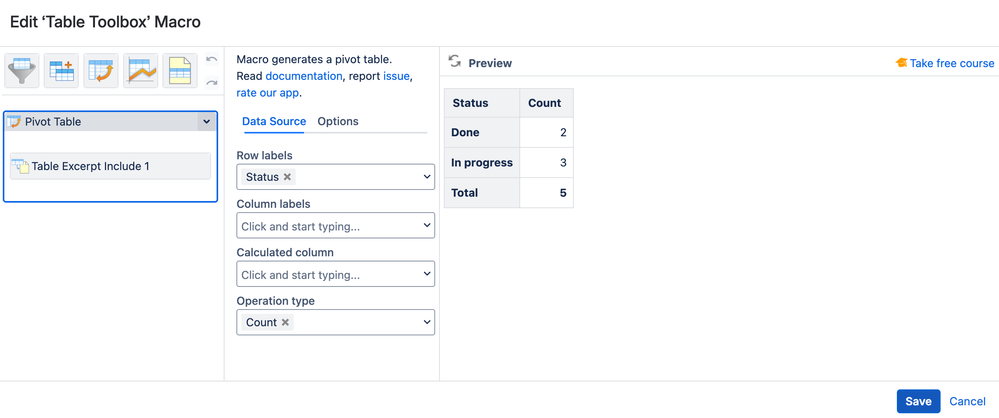

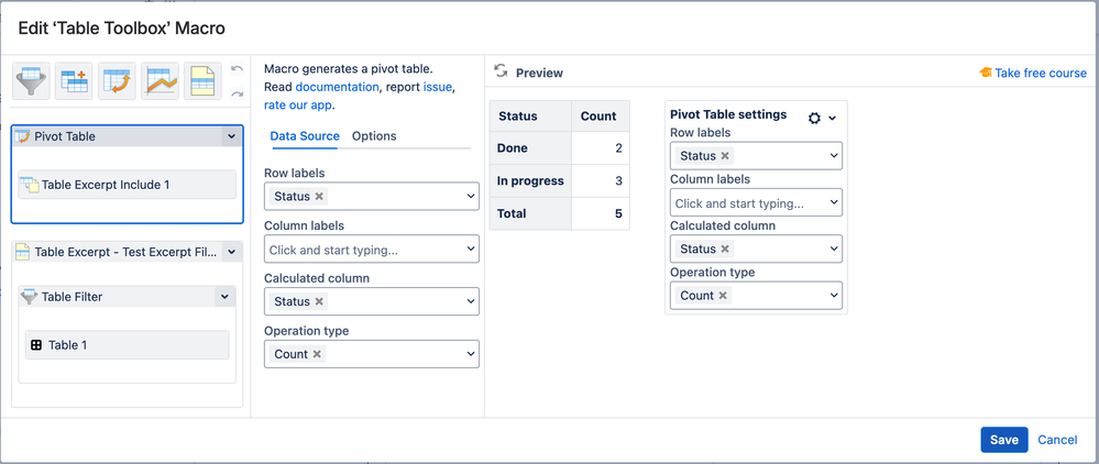

The Pivot Table structure is as following:
We create it based on the reused filtered table.

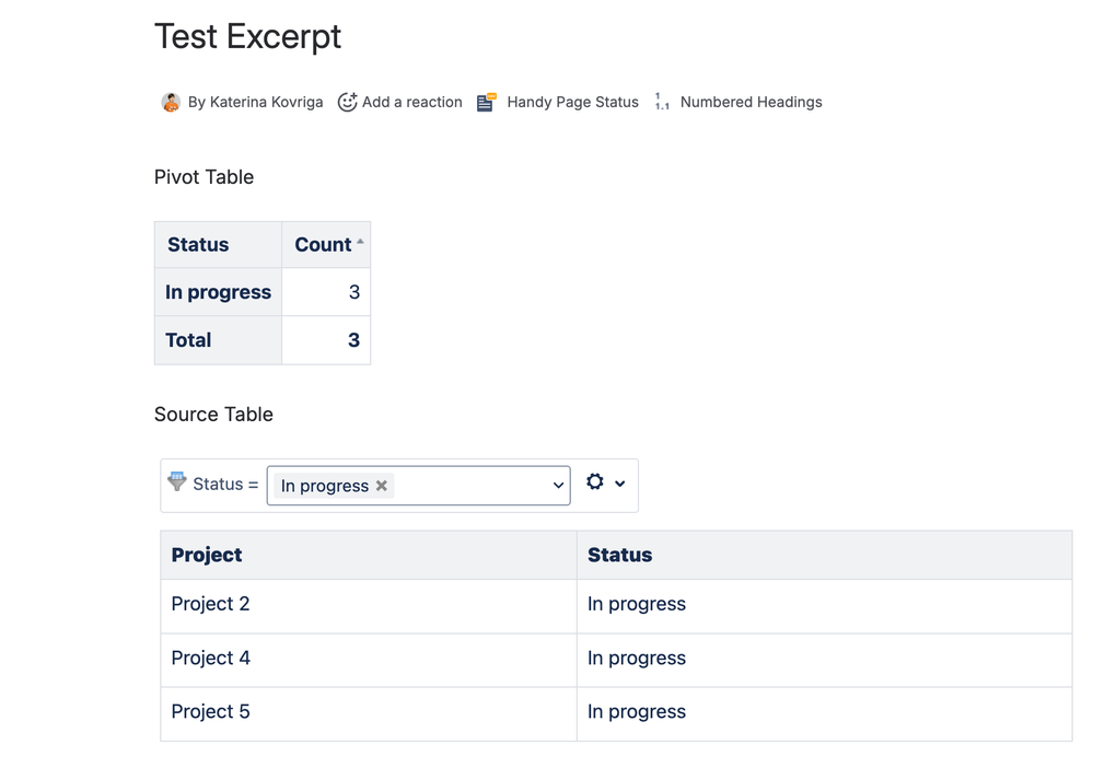

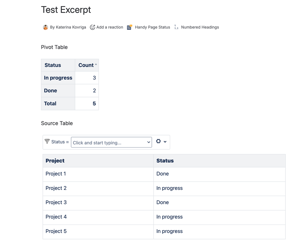

Then when the page is published, we see the following:

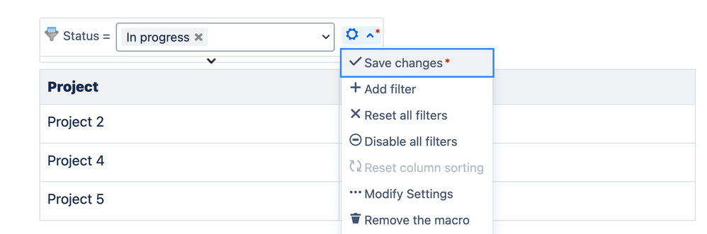

Now we can go to our dropdown filter and choose the "In progress" status.
Then we save this filter:
And reload (refresh) the page.
After that the changes get through the Table Excerpt/Table Excerpt Include macros and your pivot table is automatically rebuilt:
So, can't you be excluding either filter saving or page refreshing steps from the algorithm?

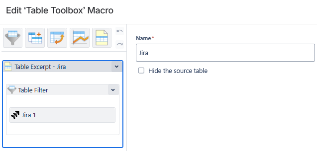

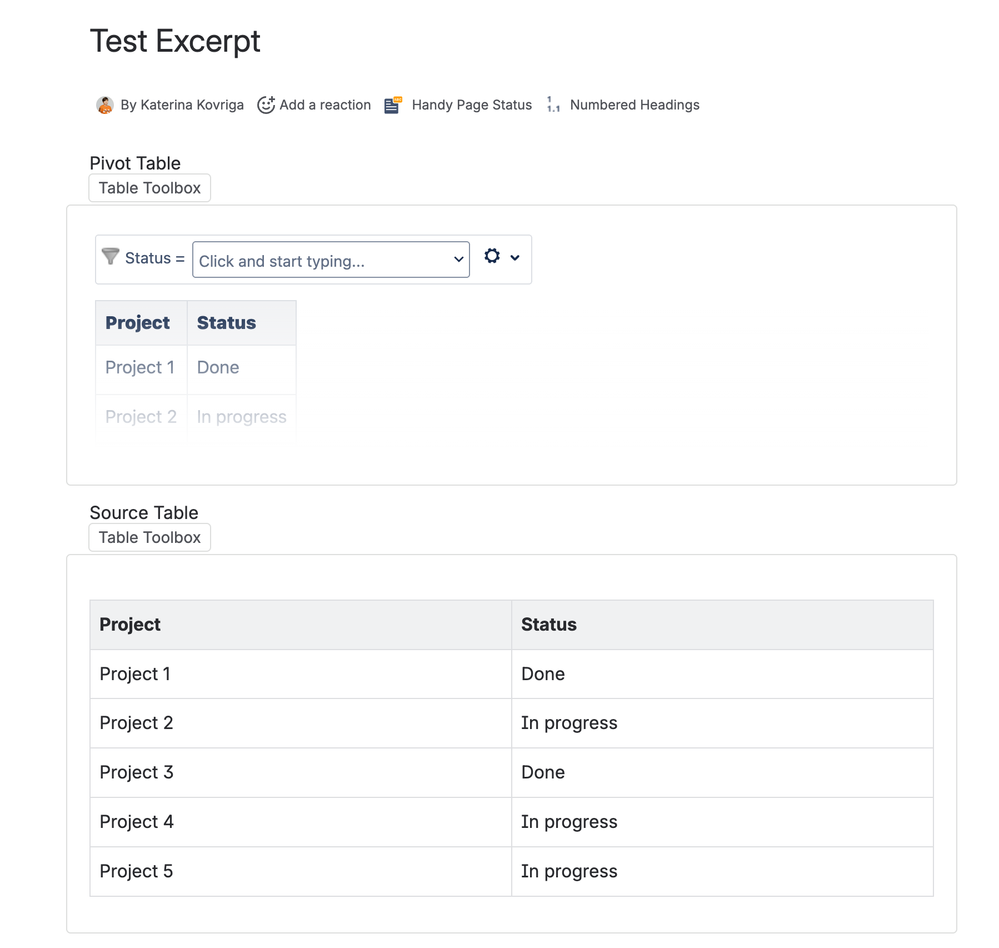

We've consulted with our developers once more regarding the discussed limitation - still nothing can be done from our side. But there is one workaround that may suit your case if you don't need to place your pivots and charts in different parts of your page (for example, using layouts).
So, the idea is to place both your source table with Table Excerpt and all the required Table Excerpt Includes with different macros on top inside the same Table Toolbox macro (that's how we can keep everything inside the same "container").

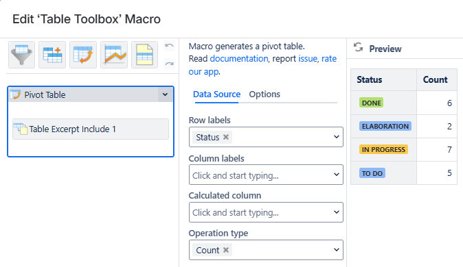

For our example the page in the edit mode looks as following:
The macro structure inside the Table Toolbox macro looks as following:

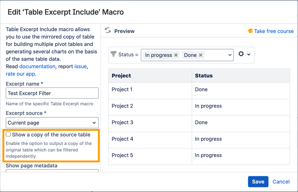

And please go to the Table Excerpt Include macro settings and uncheck the Show a copy of the source table option:
Now if you publish the page and filter your source table, the pivot table will be rebuilt on the fly like it does in Data Center.
