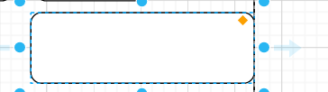

1. Step:
- I have inserted a textbox and expanded it till it hit the column boundaries. The line straight from top to bottom is the column boundary.
2. Step
I try to push the box over the boundary. Not that in the following screenshot I am still holding the box (took the Screenshot with a timer) and didn't let it go.
3. Step:
As soon as I "stop clicking" / let the box go, the coumn automatically expands till its boundary is on the right end of the figure. This is what I referred to as the objects "pushing" the column.

Hi @Blake
"I wanted to insert a textbox that stretches across multiple columns of the table to demonstrate a step that covers multiple stages."
You could try the following: start dragging the box, press and hold Alt. This way boundaries should be ignored i.e they won't be displayed as purple. Drag it over the boundaries, drop it and then extend.
Does it help?

Hi Marija, thank you very much for your answer! I tried it and it worked in the beginning but then it didn't anymore.
What I mean is: I dragged the box across the line. Then I dropped it --> boundaries were not pushed. But as soon as I extended it, the boundary I just crossed relocated itself towards the right of the box (as seen in Step 3) ....
