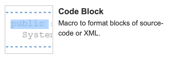

In my wiki page  if we have use Code Block micro to write some code.
I wanted to give experience to my user  as CLIP COPY do we have that feature ?
Pls suggest

I have use Code Block Macro to write my snippet of code,
I am not able to find clip copy
or
on mouse click I wanted to copy my code do we have these feature on wiki?

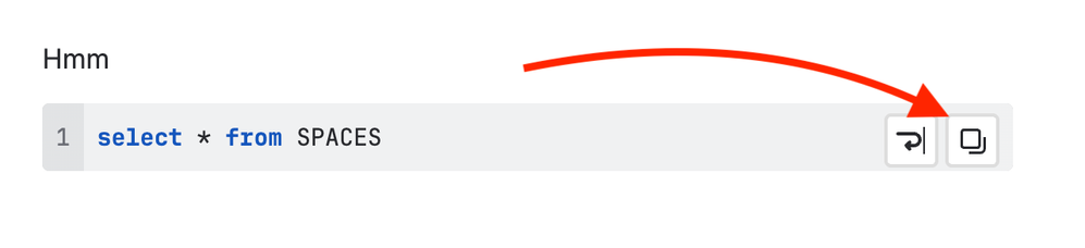

The Code Snippet macro in the new Cloud editor has a Copy button while hovering your mouse over it:
It looks like you're using the Legacy editor, so we suggest you convert your page and get the benefits of our new and enhanced editor.
Hope this helps! =]

For Data Center installs, the Code Block macro does offer the same Copy to Clipboard button when hovering your cursor over.
Notice that the Copy button will show up while in View mode after the page is published, and will likely not show while in Edit mode. Your screenshot indicates the page was still being edited, so you may want to publish it and give it a try.
