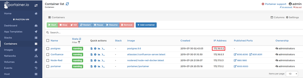

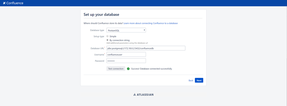

Try the PostgresDB Servers Docker IP address. I just tried it on mine and it connected instantly. Also, you need to create the database, I didnt see anything in your documents about you creating a database. To do that in docker postgres you need to run this command from your docker machine.
docker exec -it postgres psql -U postgres
First create a role
CREATE ROLE confluenceuser WITH LOGIN;
\password confluenceuser
then enter the password you want to use twice.
To check the user account created ok run this
SELECT rolname FROM pg_roles;
Then you can create your database etc.
CREATE DATABASE confluencedb
OWNER = confluenceuser
TEMPLATE = template0
ENCODING = 'UTF8'
Then grant all privs to the db
GRANT ALL PRIVILEGES ON database confluencedb TO confluenceuser;
This took me about 4 hours to work out. I am running a vanilla VMware Photon VM. Hope this helps everyone.

Here are the commands I used to create the Containers
//Creation of confluencenet (this is the network that the two containers reside on)
docker network create confluencenet
//POSTGRES
docker run -v postgres-data:/var/lib/postgresql/data \
--name postgres -d \
--network confluencenet \
postgres:9.6
//CONFLUENCE
docker run -v confluence-data:/var/atlassian/application-data/confluence \
--name="Confluence" \
-d -p 8090:8090 -p 8091:8091 \
atlassian/confluence-server:latest

To add to this setup, you can set postgres host value in Confluece DB setup page to postgres instead of 172.18.0.2 since you named it with --name postgres.
It's because Confluence docker container can reach postgres docker container by it's name since they're on the same network.
That way it will continue working if your postgres container ever gets an new IP.
