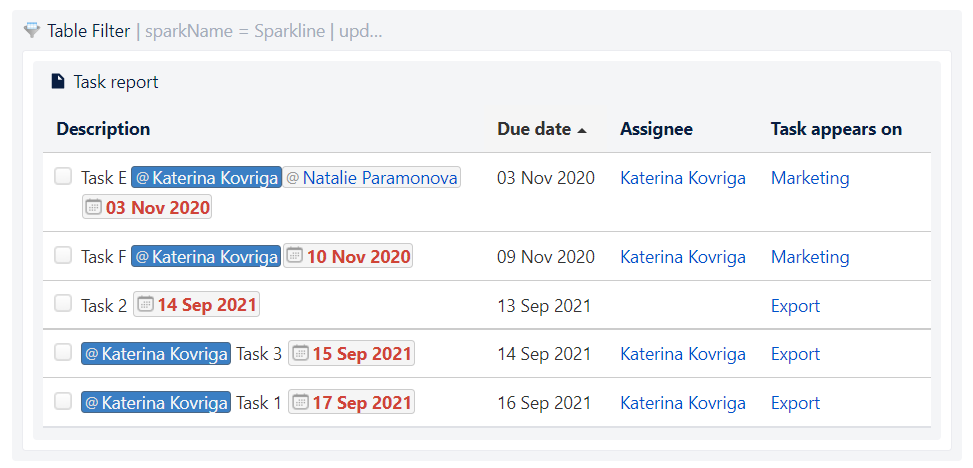

Here we want to filter the task with Natalie Paramonova - the first one. Natalie is not the assignee - I'm the one but Natalie should help me.

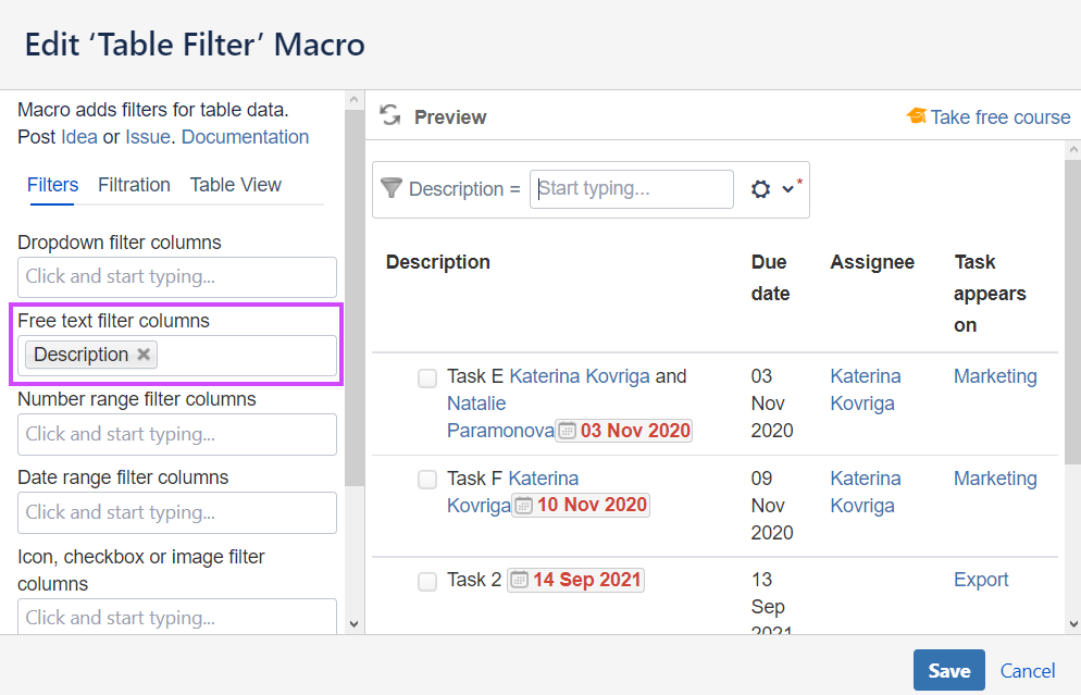

So we set a free text filter for the Description field:

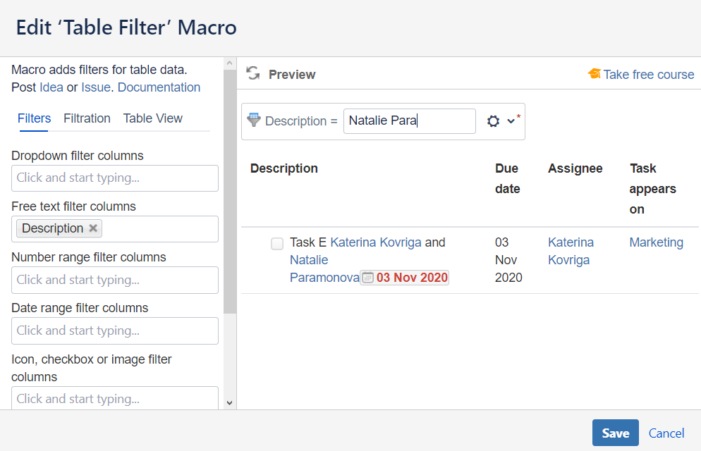

And here is our result:
Note that you can filter every column of the Task Report macro including due dates on the fly from the page view mode.
