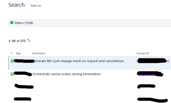

Hi,
we are missing a custom field on the jql in confluence, the column is shown but its empty. On Jira Cloud the content is shown.
Any thoughts/ideas?

Hi @Jasmine Stermschegg , to be clear you have a saved filter in Jira that you reference in a Confluence macro and you see that a custom field is blank in the Confluence macro but not when viewed in Jira, correct?
some questions/thoughts...
  • please verify that you do not have two custom fields of the same name. I have seen this before.
  • I assume you have verified this is the case on the same issue
  • I wonder if you try removing the CF from the display and re-add
  • it would be interesting to try a different filter, e.g. issue = abc-123 as a test
Jasmine Stermschegg
September 5, 2023
Hi,
yes, i tried it with a saved filter and directly via jql but its still the same issue. The affected custom field is called "Group ID" and shown directly in Jira via Filter oder JQL query but not in Confluence.

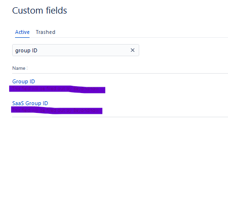

Jack Brickey
September 5, 2023
Can you verify that there is only a single Group ID field?
project settings > issues > custom fields
can you share screenshots of Jira and Confluence
Jasmine Stermschegg
September 6, 2023
Yes, we have only one "Group ID" field, its a group picker field.
Jack Brickey
September 6, 2023
Thanks for the details. I have verified the issue in my instance and consequently found this open Bug - CONFCLOUD-71510 - Jira issue macro does not show values of Group Picker fields . I recommend that you vote for and watch the issue if it's important to you.
