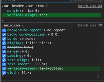

Finally, I found that the CSS class "aui-icon" of <span>Create</span> caused the vertical-align:top to move the vertical alignment down. How do I remove or ignore vertical-align:top?
<a href="/Wiki/pages/createpage.action?spaceKey=ISAM&amp;fromPageId=1081406" id="create-page-button" class="aui-button aui-button-primary clc-create-dialog-btn" title="Create from template" tabindex="0">
<span class="aui-icon aui-icon-small aui-iconfont-more">Create </span></a>

Thank you for your follow-up. Specifically, the class .aui-icon within .aui-header has the vertical align set:
Were you able to track down where the customization was made in your instance? It would help us to see the exact code you're using in order to let you know how to fix it. Please provide that to me and I can have a look for you.

I added a customized CSS to fix the position.
#create-page-button .aui-icon{
margin: -1px 0;
vertical-align: text-top;
