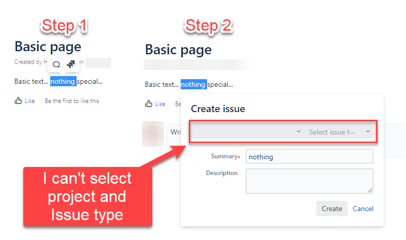

We are not able to create a Jira issue by highlighting the text in confluence. Do you have any Idea, what is going wrong?
What is going wrong?
  • If open the dev tool, I can see there is an error:
    • Uncaught TypeError: Cannot read properties of undefined (reading 'indexOf')
      at Object.<anonymous> (com.atlassian.confluence.plugins.confluence-jira-content:confluence-jira-content-resources.js?locale=en-GB:270:463)
      at Function.each (batch.js?locale=en-GB:33:1304)
      at Object.success (com.atlassian.confluence.plugins.confluence-jira-content:confluence-jira-content-resources.js?locale=en-GB:270:256)
      at i (batch.js?locale=en-GB:44:22867)
      at Object.fireWith [as resolveWith] (batch.js?locale=en-GB:44:23648)
      at u (batch.js?locale=en-GB:64:30467)
      at XMLHttpRequest.<anonymous> (batch.js?locale=en-GB:64:34025)
We are using:
  • Confluence Server 7.13.2 LTS
  • JIRA cloud
  • On both side the application link is set and has the status -> CONNECTED
  • I'm Admin on both systems

Ramy
March 14, 2022
Hi @Rilwan Ahmed
Thanks for your reply but on my instance I can't find Jira Resources Manager I only can see:
  • Confluence and Jira Content Connector
  • Jira Metadata Aggregate
And Yes I do have permission on both sides to create/read/write. And I also have tried it on different browsers and used in each the incognito mode as well.
