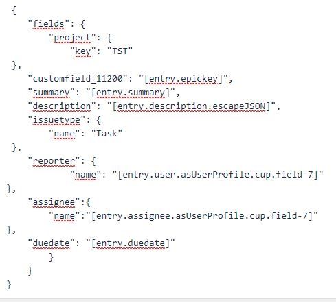

What I don't understand why is it working with Assignee/Reporter, if we using the username which are stored now in a cup.field. I would expect if we have problems by the change to AzureAD, also Assignee/Reporter should make problems.
The code below is still working...
If I try the following it wont work....
But where is the difference to Assignee/Reporter? Alle three fields refer to a user field, where the content where changed by the change to AzureAD, only watch don't work anymore if we refer to cup.field-7.

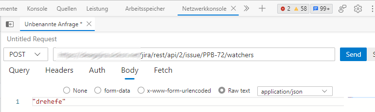

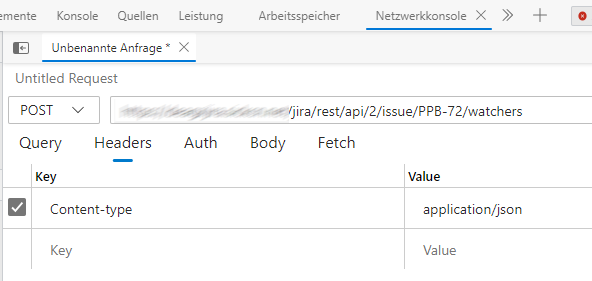

What REST API call works for you?
Michael Küng
June 23, 2023
We don't get it running with IFTTT (create JIRA Task - Watcher field WHO) and we don't get it running with a IFTTT web request.
We just get it running with e.g. the network panel from Edge.
Alex Medved _ConfiForms_
June 24, 2023
This is exactly the REST API call we are using from ConfiForms

assignee":{ "name":"[entry.assignee]"
(now e.g. marco.leist@sick.de)
to
assignee":{ "name":"[entry.assignee.asUserProfile.cup.field-7]"
(now returns e.g. leistma@sick.de - identical to user in JIRA)
So the point is that with single user fields like "assignee", the chaining with the virtual function .asUserProfile.cup.field-works very well - but not combined with the virtual function ".asArrayMultiUserPicker" which is required for JIRA fields that can contain multiple users.
