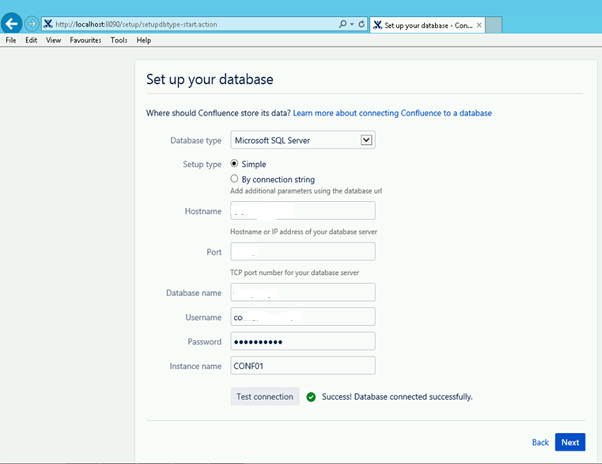

  • In the database setup, add the following:  ";domain=MyDomain" to the end of the Database URL. See the screenshot below:
My recommendation would be to add that parameter to the end of the URL. You need to select Setup Type > By connection string (Add additional parameters using the database URL).
Could you let me know if you're having any trouble with that?
