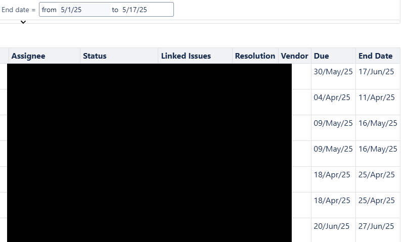

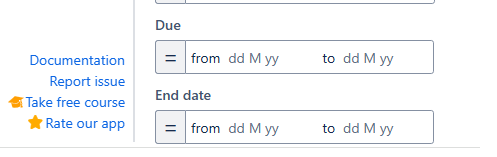

Here is how I set the filter:
And here is result:
It seems to me that there is no corresponding date format in filter macro for the one used in Jira: e.g. 08/Apr/25. Am I right?

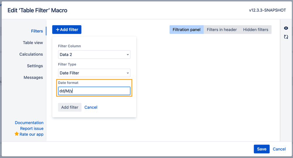

When you add the Date filter to the column, it prompts to type in the required Date format. As you have dd/M/y format in the original table, you should enter this format in the field.
Nenad Ristevski
April 8, 2025
Oh, my bad! Of course, this works! Thanks a lot!
