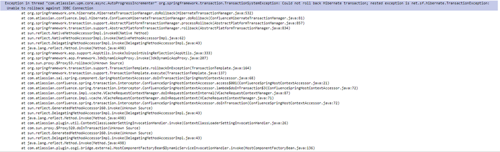

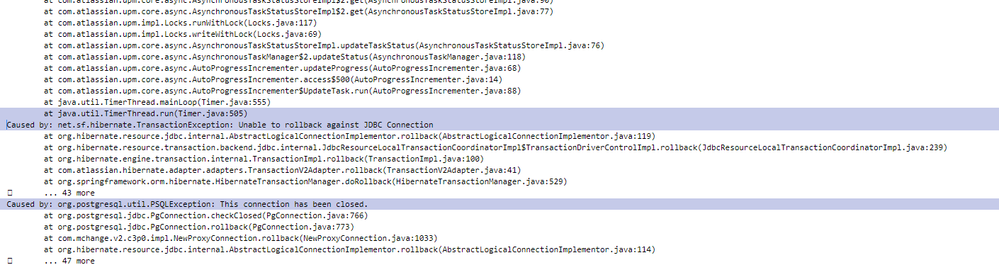

I have got several error Messages in each confluence log  while i am trying to install or update any addon. I have already successfully installed some addons and it worked fine until now.
I have tried to clean the plugin cache with no success.
I have taken some scrrenshots from the confluence log file below. Maybe you got a hint for me to solve this problem. Kind regards and thank you :)

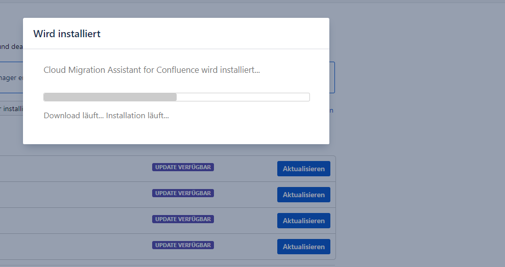

And it stucks like this :

Thank you for providing the steps you’ve taken this far along with the log output, this helps to understand what is happening with your instance. From the logs, I can see there is an issue with the database connection itself which is causing your problems. Depending on how you’ve configured your database connection, I would advise reviewing your available JDBC connections to ensure you’re not reaching the configured limits. There is an article which discusses your issue at Unable to start due to net.sf.hibernate.exception.GenericJDBCException Cannot open connection and there is an article on how to address your connection pool at Confluence slows and times out during periods of high load due to database connection pool.

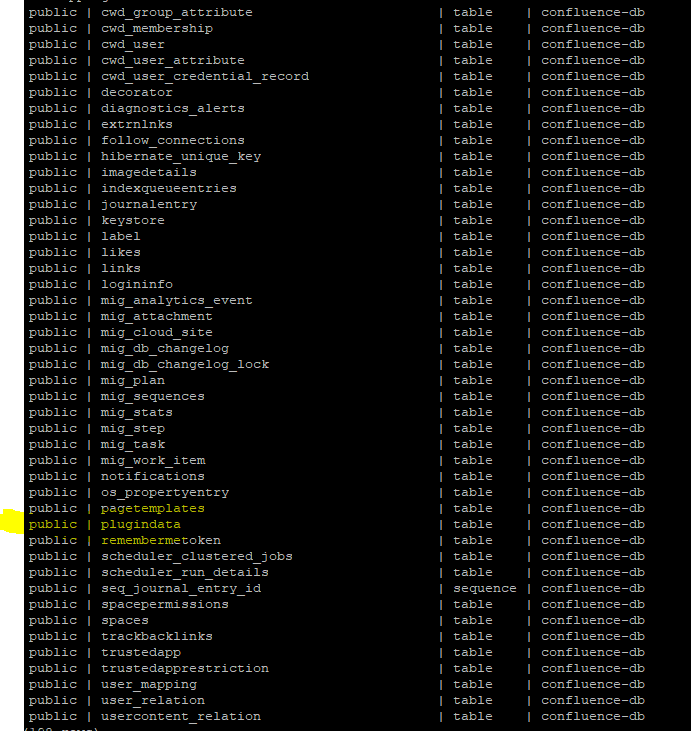

So i have checked both articles and i have tried both ways with no success. I have checked my postgres database as well. So all tables are available (for examples confluence user, spaces ....) so there should be a database connection. The database interuption only appears if i try to install a new plugin and i need to restart confluence. The strange think is i have allready installed and bought several addons and it worked fine until now. If i restart confluence and i enter the postgres container i see all tables but no plugintable but there should be one i guess ? .
Strangely if i try to install a new plugin the plugintable appears and i got some error message from the container like the picture below. Maybe there is a porblem with the Universal Plugin Manager ? We are running confluence 6.13.4 and now the Universal plugin Manager version 3.0.3. I have seen the license in confluence.cfg.xml is different to the license in the shared home folder but porbably thats not the problem.

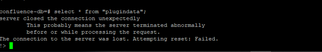

-The first picture below appears when i am trying to enter the plugindata table in postgres container

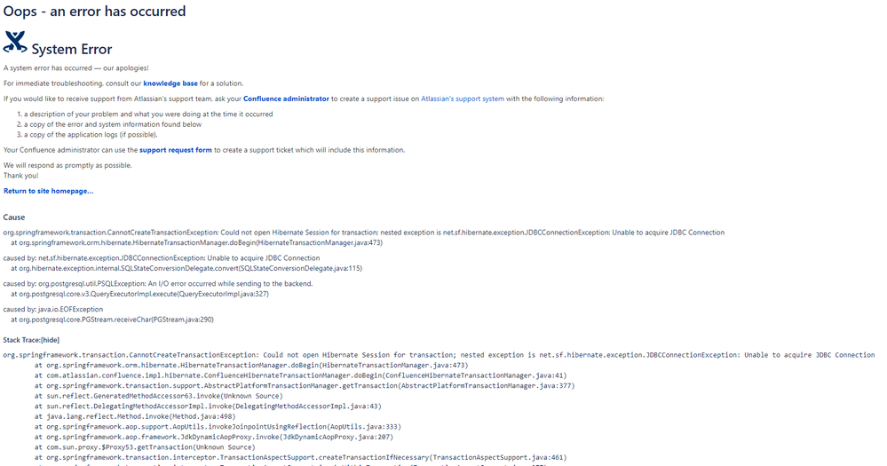

Now if i want to install an addon there was a sign for a short time "client must be authenticated to access this resource" and after that confluence links me to the error Page below.

Additionally, the screenshot you sent is still referring to a JDBC connection issue. Along with Confluence having an issue while attempting or maintaining a connection to your database. Additional steps to review out be as follows:
  1. Check that your database is up and running. If the problem has happened after a period of Confluence usage, check to make sure the database indices are installed correctly.
  2. Find out why your Confluence server cannot establish a connection to the database.
  3. Check that your username and password for your database is correct and hasn't been changed. This is configured in confluence.cfg.xml.
  4. Check your DB connection pool settings. See Confluence slows and times out during periods of high load due to database connection pool.
Source documentation: Unable to start due to net.sf.hibernate.exception.GenericJDBCException Cannot open connection
