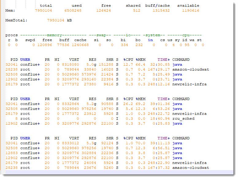

Here's a snapshot of several pieces of information I got from the command line. The ones at the bottom of the page are the output of 'top' at several different times.1-26-2023 11-54-20 AM.jpg

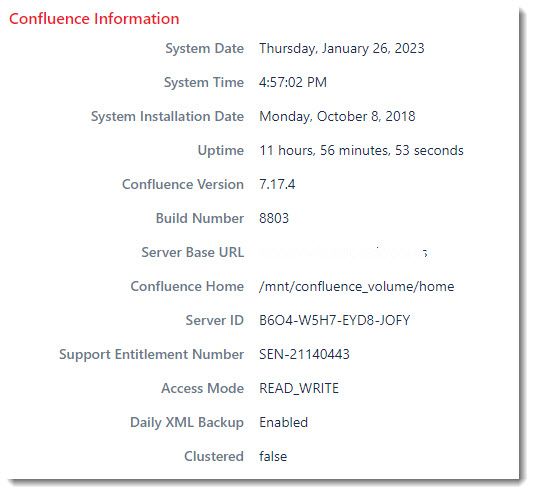

Here's the config page (blanked out the server base url just in case I shouldn't be sharing that)

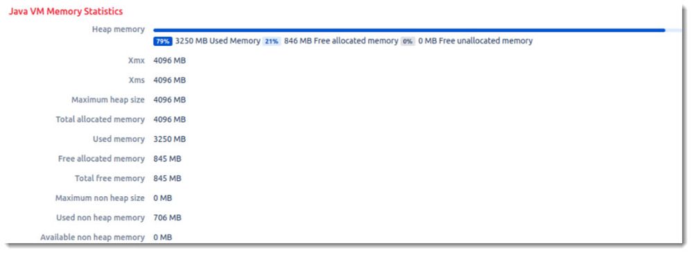

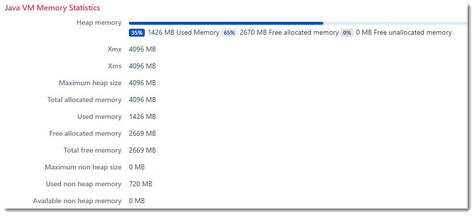

And here are 2 different points in time ss of the memory stats in confluence:1-26-2023 12-09-50 PM.jpg1-26-2023 12-09-06 PM.jpg
Anything else you need that might be helpful?
