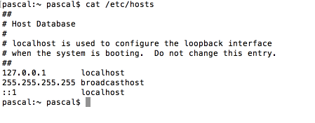

No luck, /etc/hosts already includes localhost (and is un-commented.

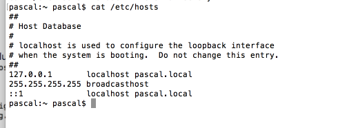

I was surprised when I ran the hostname command on my Mac. It wasn't what I expected, it didn't have the .local for one thing. Please make sure the right hostname is in the hosts file by running the hostname command in a Terminal window.
If Confluence still doesn't start, please post a new log so I can see if it's the same error.
It does include .local for me (see below).

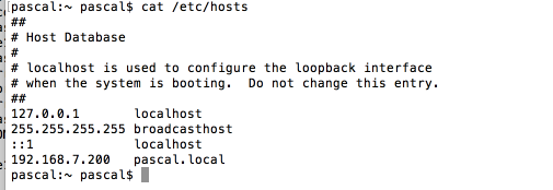

I hate to keep asking you to restart your Mac, but could you add the "real" LAN IP to the hosts file for pascal.local, restart the system and try Confluence again? I look forward to hearing whether that works.
