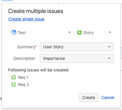

Hi,
When from Confluence, creating a new Product Management template, if I have just a single Epic created on the page, then when I perform Create Issues, then I can see the Link to Template just fine.  However, if I have 2 Epics created on this page, then I don't see the Link to Epic when creating issues.  Can you let me know if I'm missing something?  Our team want to manage multiple Epic on the same page.

Actually, both interpretations are not accurate.  Here is what I meant, and the steps to reproduce.
1)  On Confluence page, create a new issue of type Epic.  (This works).
2)  On same Confluence page, create a table, and from table create Multiple Issues of type Story.  From the modal popup, you can see Link to Epic that you created from step 1.  (This works).
3)  On same Confluence page, create a 2nd issue of type Epic.  (This works).
4)  Repeat step 2, but this time on pop-up modal, you'll not be able to see the Link to Epic anymore.  See screenshot that I've attached originally.  I'm guessing this issue is related because there are 2 Epics on page.  This issue causes me not to be able to link the new Stories to the epic on the page.  (This step fails)

Thanks for getting back to me, @vinh ! Alright, now I believe that the issue is pretty clear for me.
I was able to replicate this when I inserted more than one Epic on the same page. When there is only one, it works. If you want to look into the report, here it is:
Currently, the only workaround to the issue is to manually link them directly in Jira. We could start by voting and watching the issue. Voting helps to increase the issue visibility and watching will keep you up to date with everything posted there.
