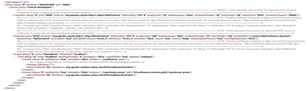

Thorsten Schmitt
April 2, 2019
Hi Diego,
thanks for your reply and sorry for my late response as i have been abroad.
So, all of your Point 1-3 i´ve been through and everything seems to be fine.
Attached you can find my server.xml (personal details have been changed):
Thanks again for your help, really apreciate it.
