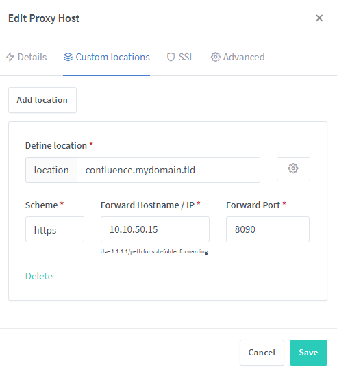

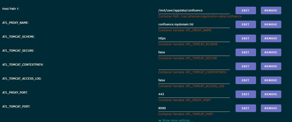

I've set up confluence as a docker on my Unraid machine and would like to make it accessible from the outside of my LAN Network by using a reverse proxy.
For that I use Nginx Reverse Proxy Manager, which worked out perfectly for all my applications so far.
I set up my CNAME record in Cloudflare, which points to the A record of my domain, which points directly to my IP adress.
When I enter the domain (confluence.mydomain.tld) in Firefox I get an 502 (bad gateway) from Cloudflare, which should mean, that the redirection works fine, but the confluence docker is not responding to back.
I saw a thread with a similar issue to mine, but that config does not work for me.
Also while using this config, Confluence displays the following error on it's homepage:
Tomcat config is incorrect
The Tomcat server.xml has an incorrect configuration:
scheme should be 'http'
proxyName should be '10.10.50.15'
proxyPort should be '8090'

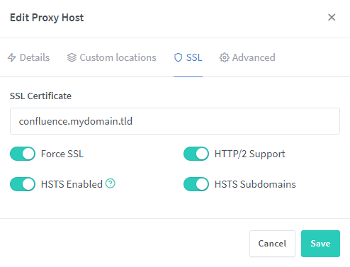

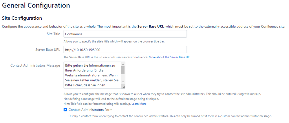

In the attachments you can see my settings in confluence, nginx proxy manager as well as the confluence docker itself in unraid.
I think there's probably an issue between the proxy manager and confluence, so my guess is, that I have something misconfigured
confluence custom paths.PNGconfluence path.PNGconfluence ssl settings.PNGConfluence Docker Settings.PNGConfluence Genral configuration.PNG

Guys, put this in Custom Nginx Configuration:
 location / {
client_max_body_size 100m;
proxy_set_header X-Forwarded-Host $host;
proxy_set_header X-Forwarded-Server $host;
proxy_set_header X-Forwarded-For $proxy_add_x_forwarded_for;
proxy_pass http://192.168.1.4:8090;
location /synchrony {
proxy_pass http://192.168.1.4:8091/synchrony;
proxy_http_version 1.1;
proxy_set_header Upgrade $http_upgrade;
proxy_set_header Connection "Upgrade";
Where 192.168.1.4 = your local ip of confluence instance.
Also:
The cloudflare proxy does not actually follow the redirect nginx sends, which results in this error. You probably need to set the SSL/TLS encryption mode to Full or Full (Strict) or remove the additional CloudFlare proxy.
