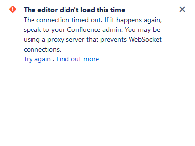

But users coming in from a different network on-site get the attached error when trying to create or edit an article.

With the proxy settings there, I'm able to reach Marketplace and update plugins without an issue; so, the proxy settings are working and I can get offnet. This Confluence is also connected to Jira for authentication and the noProxy settting for the jira URL in the same network is working too. Everything works except when attempting to create or edit from a different network. When I remove the settings from setenv.sh and catalina.properties, the editor timeout goes away, but, as you might imagine, the marketplace is no longer accessible.
