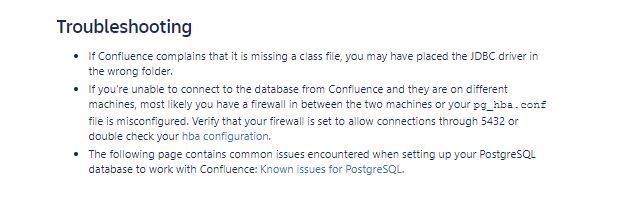

Hello - I'm sorry I mentioned MYSQL as your url pointed to MYSQL DB .
But yes , the driver issue is common among most of them , you need a jdbc driver and your error also points to the same issue.
Also - here is the link to Postgres section of the documentation. It also asks you to get the respective driver file in place.
https://confluence.atlassian.com/doc/database-setup-for-postgresql-173244522.html Capture.JPG
