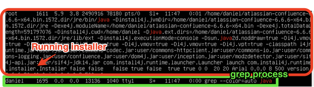

This is an interesting problem - it sounds like the installer's java is failing to launch. Let's try a few troubleshooting steps!
First, let's see if there are any stalled installer scripts. Run this to search for running java processes:
ps aux | grep java
This will return any installer process that failed to exit, the grep process itself, and any running java processes (like if Confluence did seem to finish installing and is trying to start up).
