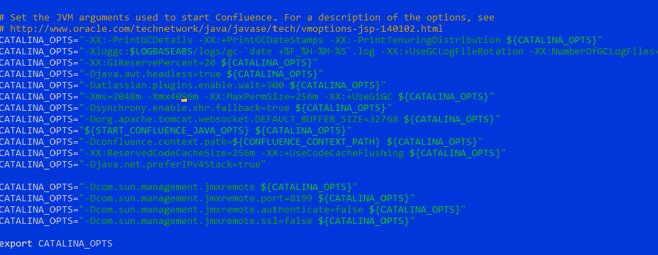

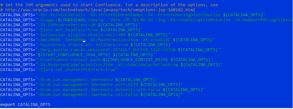

That's my setenv and startup.sh:
I start confluence from ./startup.sh
Nic Brough -Adaptavist-
October 25, 2020
It looks to me like someone has destroyed your startup.sh script by copying parts or all of setenv.sh into it.
There should be no Catalina_opts in the startup.sh
Like Nikita likes this
