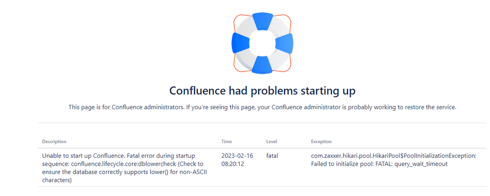

Hi together,
We have Confluence running in a Cluster.
On the first node the Confluence runs without error after installation but on the second node we get this message when I try the url direct from the server
Has anyone any ideas what we can check:
2023-02-16 08:20:12,469 ERROR [Catalina-utility-1] [atlassian.config.db.DatabaseHelper] closeConnectionOrLog Connection was null. We could not successfully connect to the specified database
2023-02-16 08:20:12,469 ERROR [Catalina-utility-1] [atlassian.config.lifecycle.LifecycleManager] panicAndShutdown Unable to start up Confluence. Fatal error during startup sequence: confluence.lifecycle.core:dblowercheck (Check to ensure the database correctly supports lower() for non-ASCII characters)
org.hibernate.HibernateException: com.zaxxer.hikari.pool.HikariPool$PoolInitializationException: Failed to initialize pool: FATAL: query_wait_timeout

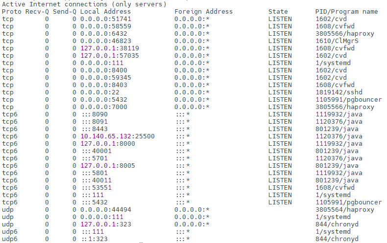

The first one, I had checked was the network and port security.
And I would say, this is not the cause, the settings for network are still the same, as from the other node.
Telnet and netstat looks well.
We used for the 2nd node 16 gb and 4 cpus. This is more than the minimal requirements.
