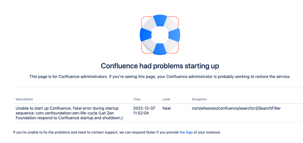

Hello,
Postgres version - 10
Confluence self-hosted.
Java version 11
Docker Images - atlassian/confluence-server (Rancher)
Error:
Description -
Unable to start up Confluence. Fatal error during startup sequence: com.zenfoundation:zen-life-cycle (Let Zen Foundation respond to Confluence startup and shutdown.)
Exception -
com/atlassian/confluence/search/v2/SearchFilter
maybe you have an idea?

Lukas Narbutas
December 7, 2022
Fixed.  i disabled all plugins
Docker File
CATALINA_OPTS  -Datlassian.plugins.startup.options='--disable-all-addons'
