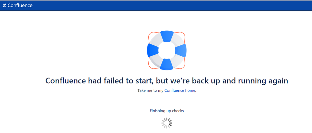

Hi Team,
we have installed the service ,but when we are trying to access the site getting an error
'Confluence had failed to start, but we're back up and running again'
PFA below
could you please suggest the solution ,is there anything that we missed?
this issue is occur only when we are connected to Prod database.
But when we are connected to QA database we are able to access the site.

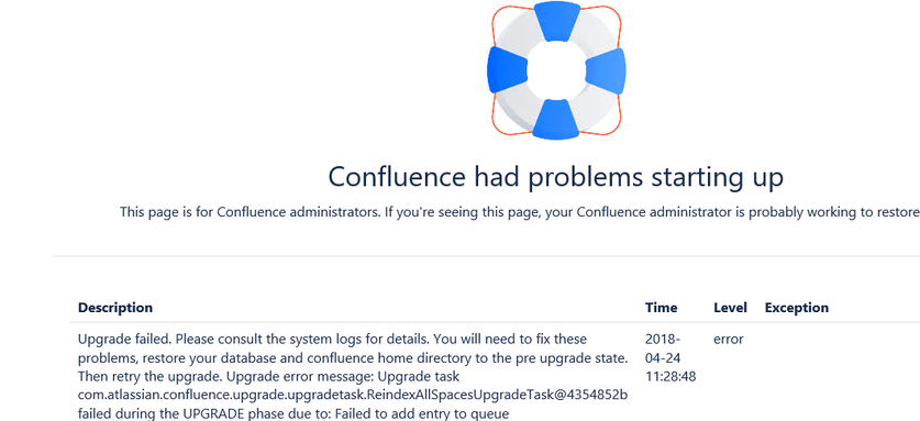

Hi Team,
we are getting following screen while accessing confluence site.confluence_starting up issue.png
following is the Home Log.
could you please suggest any solution for that

Nic Brough -Adaptavist-
April 26, 2018
There is no error in that log, you will need to read all of it.
Rajratan Dahane
April 26, 2018
yes i know.. but why we are getting the error while accessing the confluence site
April 26, 2018
Because Confluence is not running properly.  It's not able to upgrade, so it's stopped.  You need to read the logs in full to find out why the upgrade has failed.

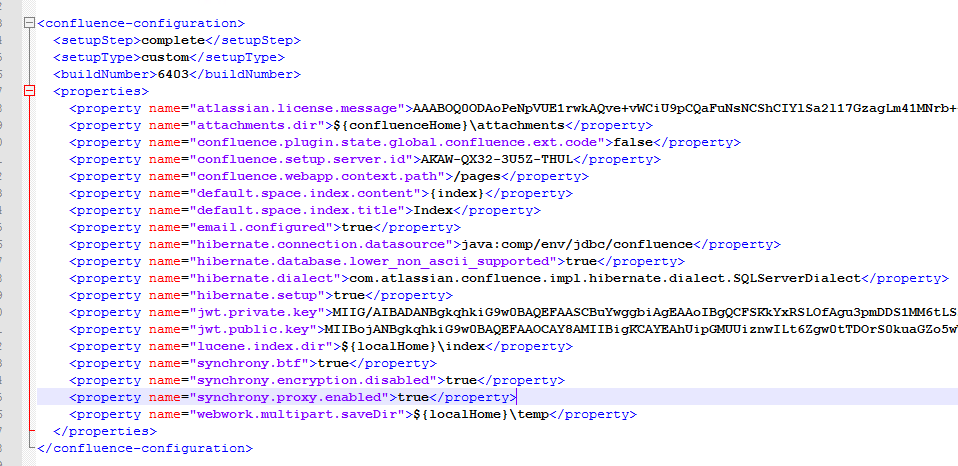

following is the Confluence-cfg.xml file
March 26, 2018
Those two answers directly contradict each other,
Please.  Do you have two separate Confluence installations, one pointed at the QA database, and the other Production ?
March 26, 2018
This warning you're getting is because it failed start up (probably because your installation mismatched the database), but restarting has fixed it and it's now working.

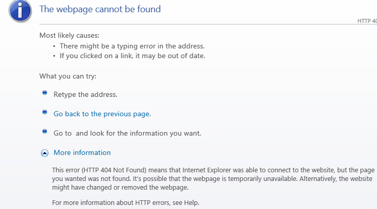

Rajratan Dahane
March 27, 2018
Hi Nic,
We have installed new service on production server with Prod DB connection.
but when we are trying to access through locally and remotly we are getting an error 404
I am attaching error screen shot.
April 26, 2018
Sorry, I missed the reply before.  That tells us Confluence is not running there, you need to check that it is located correctly and that it is running.
