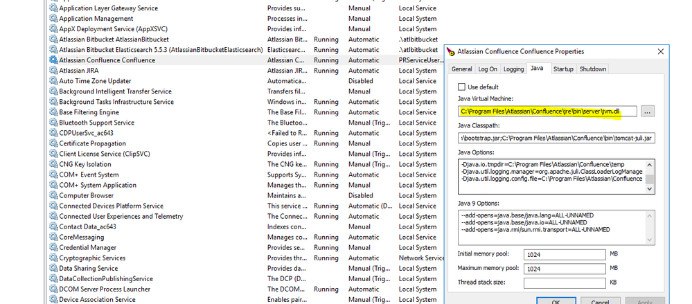

Hi
1:
When setting Confluence up as a service and restart the server, the service cannot start up.
When I manually run startup_bundled_jre.bat it starts up ok
2:
I cannot see how i can assign access to Confluence to specific users? (i share user directory with Jira). Only a subset in the beginning should have Confluence license.
/Jesper

Ok it looks like it is working now... it was the java path

prelecdev
October 18, 2018
Hi Jan-Peter
No but for some reason the service parameters did not point itself to the java boundled with confluence - so i cound this command where i could then point it to confluence java runtime..
Thanks for your feedback!!
/Jesper

In the Tomcat log i get this error:
[2018-10-17 10:37:53] [info] [ 3040] Commons Daemon procrun (1.1.0.0 64-bit) started
[2018-10-17 10:37:53] [info] [ 3040] Running 'Confluence' Service...
[2018-10-17 10:37:53] [info] [ 3168] Starting service...
[2018-10-17 10:37:53] [error] [ 3168] Failed creating Java
[2018-10-17 10:37:53] [error] [ 3168] ServiceStart returned 1
[2018-10-17 10:37:54] [info] [ 3040] Run service finished.
[2018-10-17 10:37:54] [info] [ 3040] Commons Daemon procrun finished

The Confluence service is running "local-system" which also Bitbucket and Jirs does. So i cannot set the "log on as service" on a user.
I get this error in the event log:
The Atlassian Confluence Confluence service terminated with the following service-specific error:
Incorrect function.
