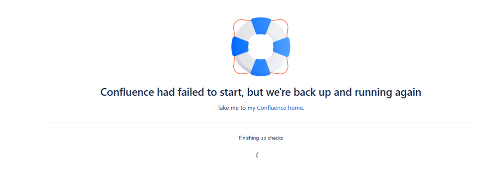

Hello ,
Trying to upgrade confluence DC from 8.5.12LTS to 9.2.5 LTS on one node, but i got this error in the screen shot and nothing in the logs.
Any ideas plz , thanks in advance.
Regards,
Charlie Misonne
June 5, 2025
"Confluence had failed to start, but we're back up and running again".
What happens when you press the link below to go to the homepage?
From you screenshot I do not see any error. Just the message that there used to be an error which has been resolved now.
Hana
June 5, 2025
Hello ,
It redirects me to the same error page
