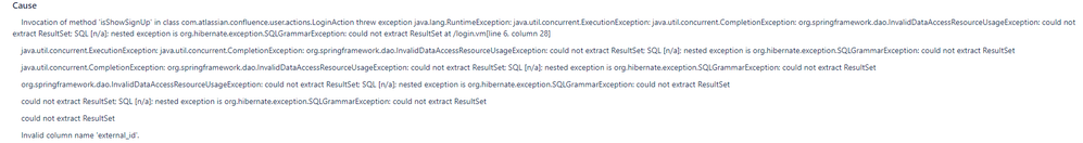

We just upgraded Confluence  from 7.4 to 7.13.1 and receiving error below when starting confluence.
Really need some help here!

Does the startup page load with errors on it?
Brant Schroeder
April 19, 2022
I think I found the issue, took a little digging.  https://jira.atlassian.com/browse/CONFSERVER-66547
