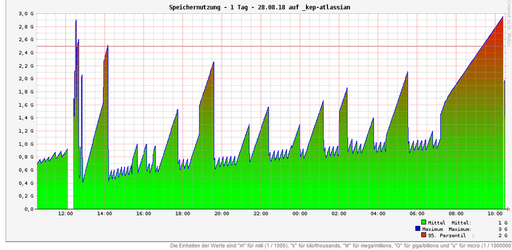

August 28, 2018

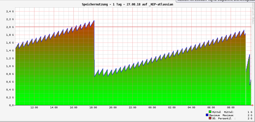

Olaf Brenn
August 27, 2018
today I got this memory consumption
Looks like a not good enough working GC - btw.- the VM has 4 GB RAM

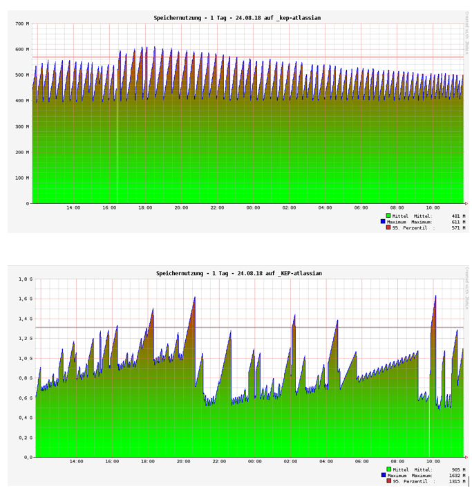

Olaf Brenn
August 24, 2018
still the installation is strange. I have pretty much the same installation for 2 companies. Both have appr. the same content. Both differ in RAM consumption as indicated in the graph.
The second has now 4 GB, the first 2 GB RAM.

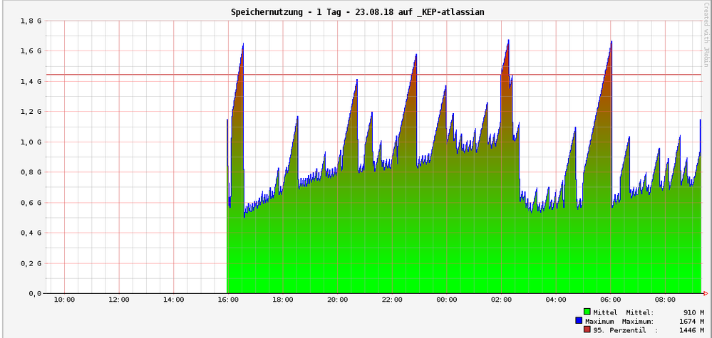

Olaf Brenn
August 23, 2018
I installed Javamelody and got the following results. I had to increase memory to 2 GB to cover the memory peaks.screen memory 180823.pngThere has to be a problem with memory consumtion.

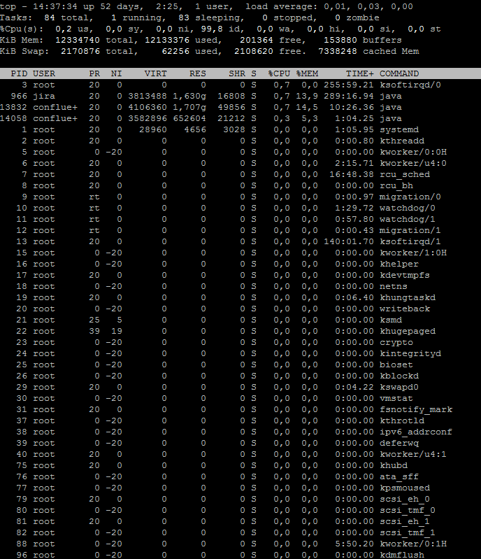

November 6, 2017
same problem with my install - works on a 12 GB RAM machine and uses all of the RAM within little time.
On my system there is no bin/setenv.sh.
Even TOP show 96 % load as well as VM proxmox.
System is rather slow and not stable.
I am very curious that the java task with user confluence us running twice - is that correct? Is there any place to see which task are configured by atlassian - I mean ports and services?
 Olaf
btw. we run jira and conf. on the same server
btw.2 I have 2 different machines with atlassian tools, both behave the same  way
