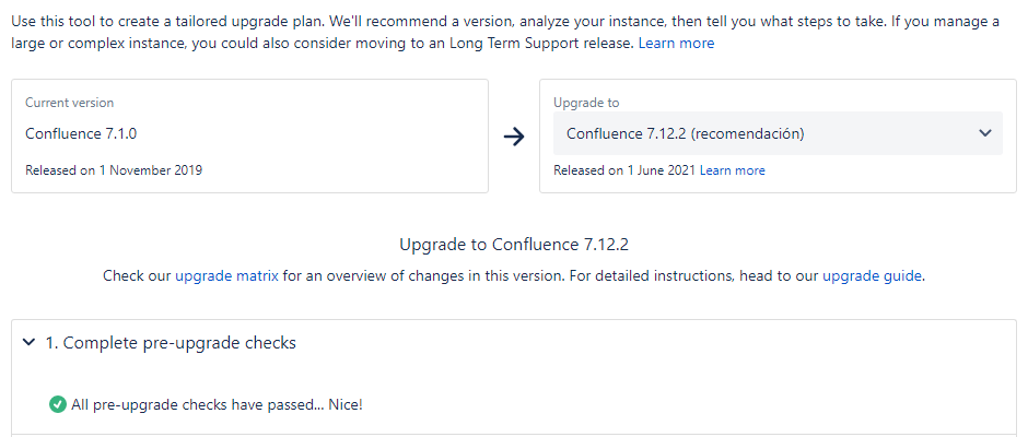

After receiving several "End life" warnings for some days I decided tu upgrade my Confluence (Server) from 7.1.0 to its latest version (7.12.2).  Everything seemed to be fine, and also the Windows service starts, but I only get "The service is unavailable." in my browser.

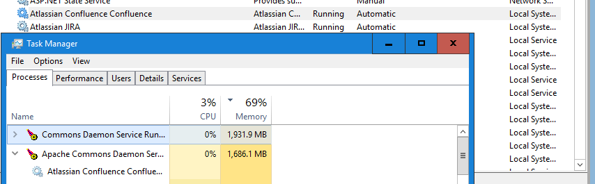

Fabián Olivera
June 9, 2021
The Confluence Windows Service is actually running, but it just doesn't work:
