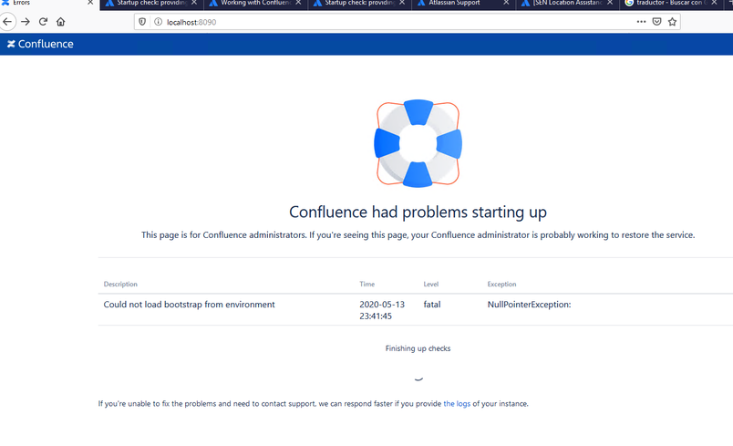

When I try to log into my Confluence account, it gets me the following error: "Confluence had problems starting up".

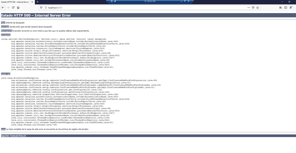

David_Canalejo
May 18, 2020
Hi,
We have already reinstalled Confluence and now we get another error:
Can you tell us how to proceed and give us a guide?
