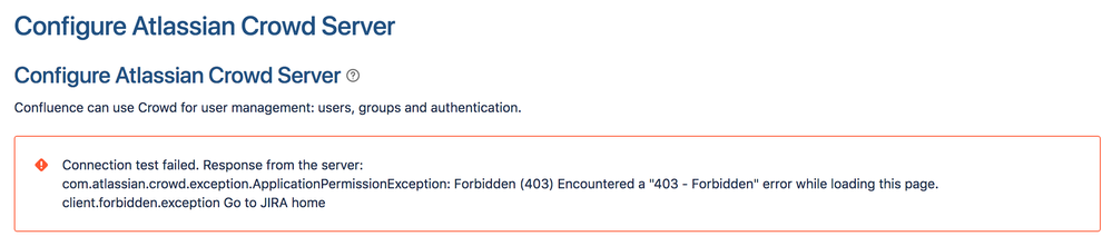

Then, when I test the connection from confluence to jira, this error pops up:
Screen Shot 2018-02-16 at 15.17.01.pngThis is the first time I see this "Crowd Server", to be honest. We have not bought this sever nor configured it in the past. Anyway, if I try to add a new Directory (Confluence > User directories) and select Atlassian Jira the error is the same.

While Crowd is a standalone product, each of the main Atlassian applications (jira/conf/bb etc) run "embedded Crowd" for user management which is why you're seeing it referenced.
Trying to authenticate to a Crowd application with a bad username and password returns a HTTP 401, but get the user/pass right but from a different source IP and you get a 403 (which is what you're getting).
You did mention in your3rd point that you'd "disabled the Whitelist for Confluence and Jira" but it really feels like this is the most likely issue, so want to confirm what you did.
  1. Go to https://jira.mycompany.com/secure/admin/ConfigureCrowdServer.jspa
  2. Edit your existing application (likely Confluence)
  3. Add the following to the "IP addresses" textbox:
    1. *.*.*.* (allow everything) - see if you can the login from Confluence
    2. If that works, change the *.*.*.* to 10.12.0.0/24 and check again
    3. Confirm the Confluence servers IP and change to it (eg: 10.12.0.10 ) to make it more secure
If you can, check the atlassian-jira.log for a line containing the string "Client with address" and it should tell you what the Confluence server is reporting to Jira as.

Thanks, it's working. I love you!
Instead of 10.12.0.X/24 I wrote 10.12.0.X, so I suppose Confluence acted normally and used the /8 range instead of the /24. Such a stupid error, sorry for wasting your time Craig.
