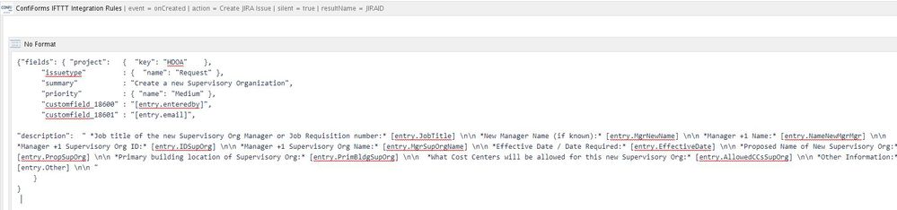

I forgot to add that i do have a 4th IFTTT, and that one is onCreated, Create JIRA issue.
The Watchers section of that IFTTT is Blank, and i am not populating the watcher or reporter fields. Refer to attached.
Alex Medved _ConfiForms_
November 18, 2020
If you dont set the watchers then the user creating the issue is not added as a watcher, but as a reporter only (unless you have some custom automation rules).
And this is why they get a message later or on issue creation.
And reporter field is populated as a "standard workflow" - Jira sets the reporter to the user's account who has reported the issue. You need an automation to change that on Jira side (nothing to do on ConfiForms side, unless you switch to "web service" request IFTTT to create an issue using service account)
