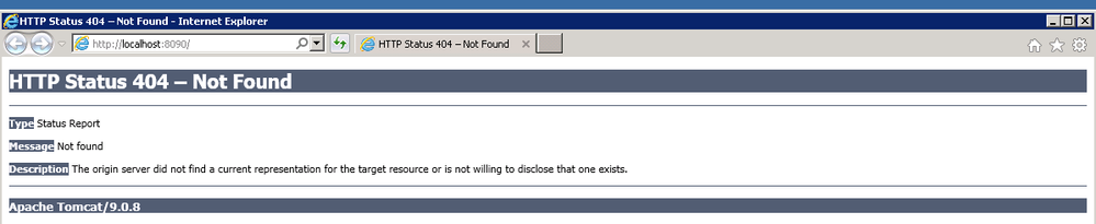

For anyone getting this message, in my case it was as simple as me not adding the context path (in my case /jira) instead just accessing the port instead. Adding the /jira to the ip-address:port solved my problems.
So, what I did. I found the backup of the HOME directory. And I have a backup of the SQL Database.
So
- I uninstalled confluence, deleted folders.
- downloaded version 6.7.0. installed this version and loaded back the HOME directory.
- It is still not running, DB access is OK, I checked the database name and password and port.

MS SQL is still refusing the user credentials:
com.microsoft.sqlserver.jdbc.SQLServerException: Login failed for user 'Confluence'.
Please make sure the Windows authentication mode is set to mixed.Database Setup for SQL Server
SQL Server allows two types of authentication: SQL Server Authentication and Windows Authentication. To make sure Confluence will be able to connect to your database you'll need to set your SQL server to allow Mixed Authentication (both SQL Server and Windows modes). This setup is generally found under Properties > Security > Server Authentication.
Hi Lukas,
What was the behavior when Confluence wouldn't start after the disk space was cleared? Was there an error then?
What steps did you take to upgrade Confluence?
Please check for errors in:
Thanks,
Ann
Hello, It wont start, I have no idea about errors :(
I tried to update it to the latest version, but not succesfull. So I even uninstall it, install it again, i have the ZIP backup, but also not succesfull.
now, I am trying to run the 6.10.1 x64 version, logs are attached.
https://www.dropbox.com/s/bqoai0m3t5niaa9/logs.rar?dl=0
Java on server - latest version...
Hi Lukas,
Thanks for the logs. Please check the the database user password has not expired, based on these entries:
2018-07-24 12:14:40,894 WARN [C3P0PooledConnectionPoolManager[identityToken->1mv4z2c9w1kjdv721j50fz4|2e472afa]-HelperThread-#0] [mchange.v2.resourcepool.BasicResourcePool] log com.mchange.v2.resourcepool.BasicResourcePool$ScatteredAcquireTask@35cd850c -- Acquisition Attempt Failed!!! Clearing pending acquires. While trying to acquire a needed new resource, we failed to succeed more than the maximum number of allowed acquisition attempts (30). Last acquisition attempt exception:
com.microsoft.sqlserver.jdbc.SQLServerException: Login failed for user 'Confluence'. Reason: The password of the account has expired. ClientConnectionId:b32908e7-8fd7-4e37-9e1d-2fe5f2ecfb5b
I hope Confluence will start once the password is reset. Unless the new password is the same as the old one, it will also need to be reset in the confluence.cfg.xml in the line:
<property name="hibernate.connection.username">username</property>
I hope Confluence starts as expected after making these changes.
