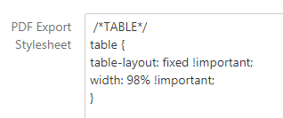

Kevin Marlowe
September 12, 2019
Hi
I was having the same issue with format of tables while exporting to PDF.
I found the below code entered into PDF Export Stylesheet fixed the issue
 /*TABLE*/
table {
table-layout: fixed !important;
width: 98% !important;
I hope this helps correct your issue.

Laura Schneider
September 12, 2019
@Kevin Marlowe Thank you so much for sharing your code! Regrettably, this doesn't help me, however. I've been testing versions of this for a few days now, on and off. And so my search continues. Thanks for your help, however, as this might solve someone else's problem!
--Laura
Here's what I'm seeing...
The code you provided causes the following on my system:
Line 1) table-layout: fixed !important;
    This code seems to be ignored regardless of the table composition/appearance in Confluence and regardless of whether I include your second line (below). It /should/ work, I think, but it doesn't seem to be.
Line 2) width: 98% !important;
    This code causes all tables to be 100% of the PDF page width, with equally sized columns, regardless of the original size or content of the cells in the columns. Example: A table with a column containing a single character, "X", is the same width (49%) in the PDF as a column containing "supercalifragilisticexpialidocious test test test test test test test test test test test test test test test test test test test test test test test test test", which is clearly not what I want.
So, what I'm seeing is that, when text wraps in cells in the Confluence text editor, this command causes my table columns in the PDF to end up scaling out across the PDF page to some relative width that allows the text to wrap, up to 100% of the available CSS-defined page width. Some columns come out way too skinny with odd text wraps, some come out oddly too wide. They do not stay proportional to the original table's appearance in Confluence, either. This is highly undesirable. I cannot, for example, get one table column to avoid wrapping a column of dates at the "/" mark, although there is plenty of room on the page. That last seems to be a character issue as much as anything, but it is similarly frustrating with simple numbered rows in a table, for example part numbers and descriptions of the part.
I've tried manually editing the HTML to set the width at a particular px in the confluence editor, but that did not translate to the PDF either which surprised me. Still investigating and testing manually editing this, however, and working with the CSS controls.
It seems like the Confluence "Export to PDF" generator function might be non-compliant with W3C--or it is being overridden by something--when it comes to creating the PDF file based on my CSS, however. I say this because literally printing the Confluence page and saving it as a PDF (CTRL-P using the "Adobe PDF" printer driver or the "Save as PDF" option) creates a more reliable PDF file with respect to the layout of the tables. I would use this, except that it includes all of the headers, footers, and default graphic stuff that you need to use the Confluence content but that is inappropriate to print, and it prevents you from using CSS to create the headers and title page and other things.
