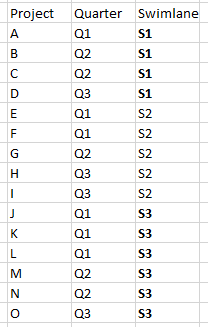

I do follow your first point, which is to make a table with ALL of the issues using general JQL. As an example, that would give me something like this (simplifying):
and then through the magic of Pivots or other Macro wizardry, I would like to display it like this:
Is that possible?

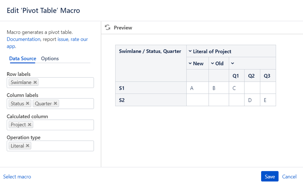

Yes, smth like this is definitely possible, please check the example below:
Instead of the manually created table that I've taken for my example, you should put the Jira Issues macro inside the Pivot Table macro (our macros support dynamic Confluence tables such as Jira Issues, Page Properties Report, Content Report Table).

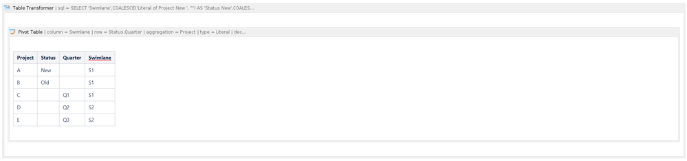

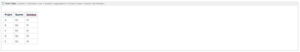

Here is my simple example with the 'Status' column and 4 quarters in the 'Quarter' column where I rename columns with the help of the Table Transformer macro:

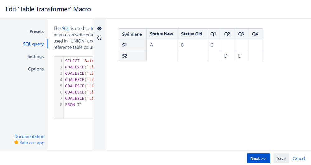

SELECT 'Swimlane',
COALESCE('Literal of Project New ‎', "") AS 'Status New',
COALESCE('Literal of Project Old ‎', "") AS 'Status Old',
COALESCE('Literal of Project ‎ Q1', "") AS 'Q1',
COALESCE('Literal of Project ‎ Q2', "") AS 'Q2',
COALESCE('Literal of Project ‎ Q3', "") AS 'Q3',
COALESCE('Literal of Project ‎ Q4', "") AS 'Q4'
FROM T*
If you have Q5, Q7, etc. quarters in your original table and you want to collect them under the label "Later", for example, you may use another Table Transformer macro between the source table and the Pivot Table macro.
In this Table Transformer macro you will use the "CASE WHEN" statement and change specific quarters to the label "Later" for the original "Quarter" column. Please check here for an example.
As you can see, our macros are rather flexible. So, if you are stuck with smth, please refer to our support: attach a screenshot of your original table and describe what you need to achieve. The portal is confidential and we will guide you through all the steps there.
P.S. The first screenshot was taken for Data Center, if you are on Cloud, you should wrap macros via the Table Toolbox macro. Other steps/queries are the same.
