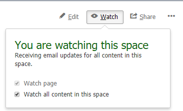

Then the other part of the User advice is two opt-in selections:
First, when they next visit their Spaces, click the EYE icon in your selected Space and tick "Watch all content in this Space" ... note this is an individual Space OPT-IN process so EVERY user can choose which of all the Spaces they have access to they wish to watch ... that includes the Executives who must also make such a decision

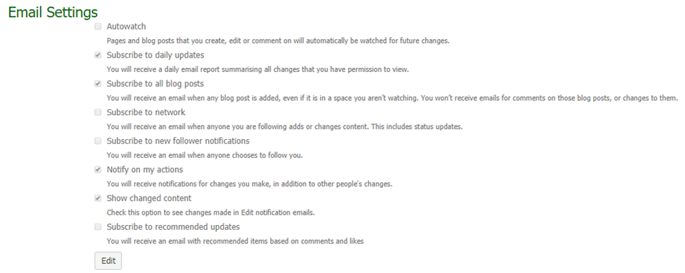

Second,  (Now this is the annoying part that I would recommend Atlassian change the location) ... is to change your email alert settings.
Click your Avatar menu .. it will give you a few options:
One is <<Settings>> but that is NOT where you will find the email alert settings!!! :(
The one you need to click is <<Watches>>, then scroll to the bottom of the page (I have over 400 Spaces to manage so my page is quite long).
There at the bottom you will find a sentence:
"You can set your email notification options on the email settings page."
"email settings" is a link to the settings you need to select.
Now set two of the options as a recommended MINIMUM:
  • Subscribe to daily updates
  • Subscribe to all blog posts
The "daily updates" means they will get a single email covering all their Spaces they are watching
The other recommended option to set is
  • Show changed content
This third one means that the alert emails actually show you what the editor has done so you don't even have to open the page to see that it was just a typo error correction :)

a) in the Space itself , <<Watch all content in this Space>> AND  in their first editing a page session, UNTICK <<Notify watchers>>
b) in their personal Watch list email settings,  Select <<Subscribe to daily updates>> AND <<Subscribe to all blog posts>> AND <<Show changed content>> .. the last one is very helpful that then they don't have to visit the page to see what has changed - the changes are shown directly in the email :)
