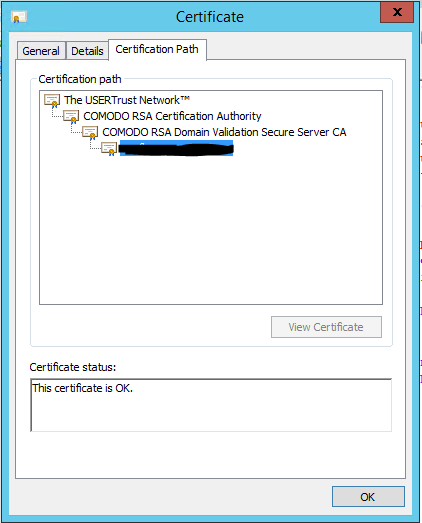

I've acquired an SSL cert for our confluence instance (Windows server 2012) and I'm having some difficulty with installing it. I've gone through the documentation on here but we still run into an issue where the site is not secure. Any ideas? Here is what the cert looks like.

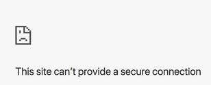

I went through the process of importing the cert & then I imported the root & intermediate certs as I saw in some of the documentation. After doing so I made the changes to the base url and the xml as documented and restarted the instance. When trying to navigate to the https link we get the below message.

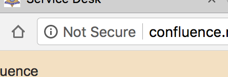

However navigating to the http link does work but displays the messaging below

Lastly, if you click on that *Not Secure* error in your address bar, can you show me the information that is provided?

This occurs in any browser & I will get you a screenshot of what shows up on the address bar.
