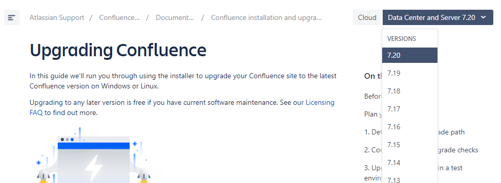

Your best companion is Atlassian reference for confluence upgrade which covers also the planning phase (Select the target version for the upgrade)

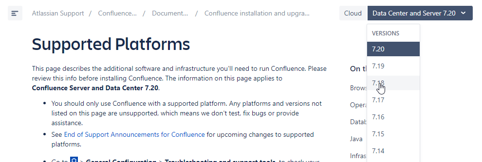

It's also worth to mention to check the ensure that you have the same platform for both instances. you can refer to this link (Select the target version for the upgrade)

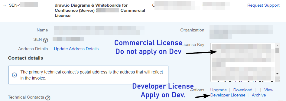

As the extra plugins exist in prod, it means that you already have a commercial license. In this case, you can obtain a Free Dev license on top the commercial one which never expires and can be used for as many Dev instances as you need.
  1. To obtain your Dev license for each plugin, please log in to Licenses - My Atlassian with your customer account, expand each plugin and get your developer license.

My Answer: because the prod license can be used for one instance only, otherwise, it will not comply with Atlassian Terms and conditions for License Usage and may cause issues if you apply a prod license to two instances at the same time.

My Answer: while it's technically possible to apply the same commercial license on both Dev and prod, it's not compliant with Atlassian terms and conditions. I cannot assure that no errors will arise when you restart confluence services.
Applying Dev license is really easy, free and safer to avoid any unexpected issues due to non-compliant setup.

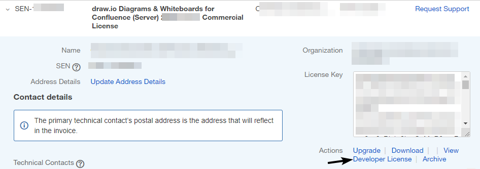

Karim ABO HASHISH
December 5, 2022
hi @Kanaka Ponnuru Prasad
Please find below the steps in a more elaborated way.
You need to be the technical contact for your commercial license to perform the below steps
  1. Log in to your Atlassian account.
  2. Under the "Licenses" heading, all of your licenses will be displayed. Click the '>' sign next to a specific plugin to view its details.
  3. Click the 'View Developer License' link in the bottom right corner of the license detail panel, below your commercial license key.
  4. Copy the Dev Key and apply it on your Dev Instance.
  5. repeat the steps for each plugin
