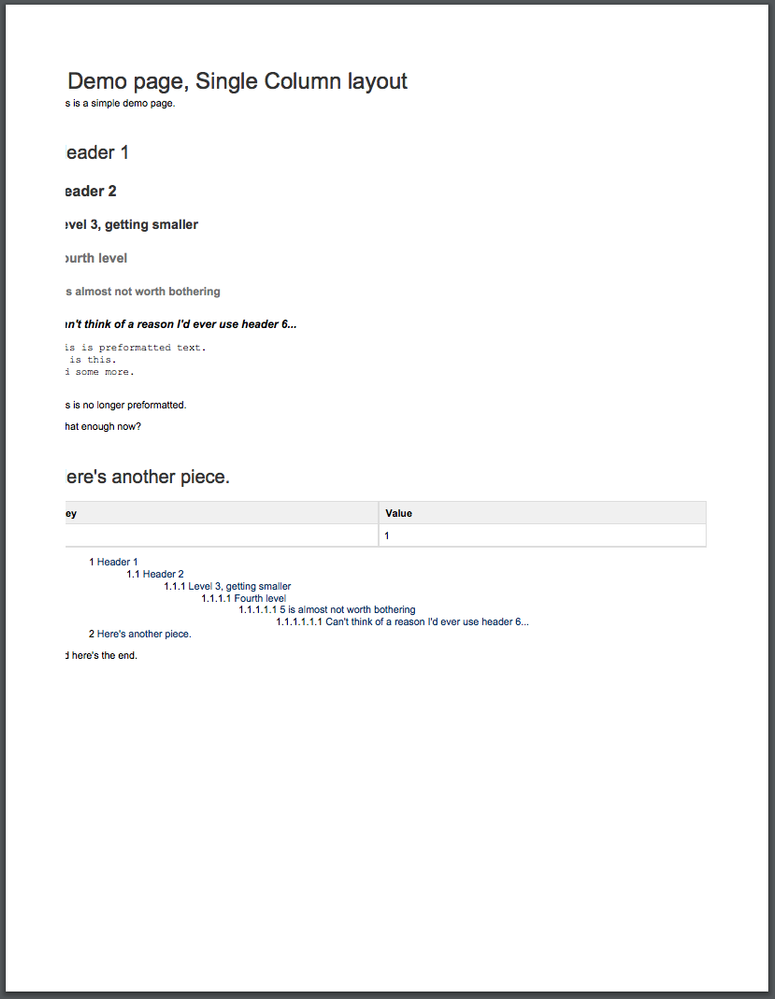

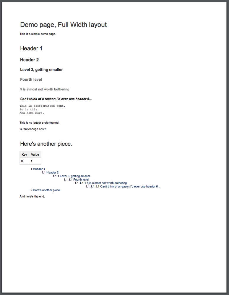

Mac Newbold
April 20, 2018
Here are two examples. One when I export PDF using "Single Column" layout, which cuts off left edge, and one where the only change is to switch to "Full Width" layout, which works fine on paper, but is not very usable when viewed online on a wide screen, because it makes extremely long lines that are hard to read.
screen at 2018-04-20 at 9.08.42 AM.pngscreen at 2018-04-20 at 9.08.23 AM.png

Mac Newbold
April 23, 2018
We're using the Cloud version:
1000.0.0-81f15a8ab0a
No custom PDF export stuff, just totally vanilla.
Mac Newbold
April 23, 2018
Also confirmed It happens on other pages, not just this one.

Mac Newbold
April 24, 2018
Okay, there are two demo pages here: https://vivint.atlassian.net/wiki/spaces/~358430864/pages
Here are screen shots of the PDFs I get out from Export PDF, using the method you describe above.
Below them is a screenshot of what I mean by Full Width vs Single column. To recreate, Edit a page. In the top bar, there's a Page Layout icon (box with two rectangles inside it). Click that, and it brings up the Layout bar, as shown in the screen shot. The first icon in the bar is the Full Width (default) layout, and I'm hovering over the Single Column layout.
The _only_ difference between these two pages, after I copied the Full Width one, is the title, changed for clarity, and the Layout switch.
Please confirm you can duplicate this.
Browser: I'm using Chrome Version 65.0.3325.181 (Official Build) (64-bit) on OSX at the moment, but since the PDF export happens on the server side, it doesn't seem to be dependent on my browser or OS.
screen at 2018-04-24 at 5.08.01 PM.pngscreen at 2018-04-24 at 5.07.50 PM.pngscreen at 2018-04-24 at 4.49.45 PM.png
