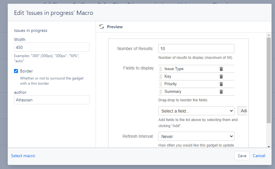

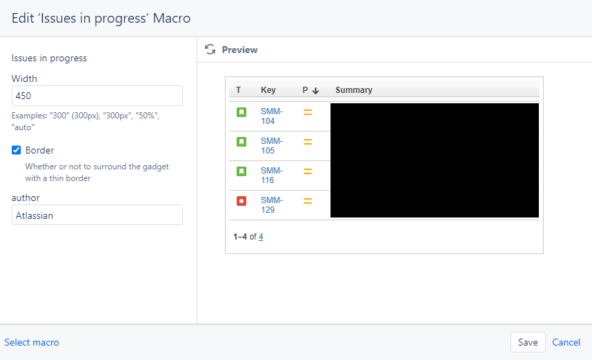

I created a team-managed Jira project using the Kanban template and chose the option to have a related Confluence space built and linked/integrated. Within that new Confluence space, when I edit a page and try to add the 'Issues in progress' macro, it winds up showing issues/tickets from an entirely unrelated Jira project. None of the Jira issues from the related project show up; only the unrelated project's issues show. Many of the other issue-type widgets/macros have a field where I can specify the project to pull issues from, but not this one. I'm lost on how to use the 'Issues in progress' macro, getting it to show issues from the actual, related Jira project.
My Jira project and its related Confluence page share the same key of 'JST':
But when I add the 'Issues in progress' macro to a page in the JST Confluence space, it ONLY shows issues from an unrelated Jira project with key 'SMM'.

Thanks for the welcome and the reply. Unfortunately, I think you're talking about the 'jira issues macro' and not the 'issues in progress macro.' This specific macro doesn't seem to provide any wat to supply a filter/jql string/etc.
It seems like there's no config available at all to define which Jira project to pull issues from or to supply a filter/jql.

Issues in progress, this just look at all your issues in progress. This is not a default macro from the Confluence product
It seams all your issues, so not related to a project, but in the Jira instance based on status or status category are being fetched by this macro

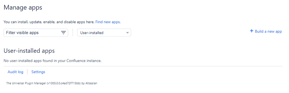

Which marketplace app is providing this macro?
Daniel Burke October 31, 2023
I have not installed any marketplace apps nor done any custom configuration. I created a Jira project and checked the box to have it create a linked/related Confluence space. So Confluence is providing this macro out of the box.
Also, it only shows the 4 'SMM' keyed issues when I create the 'issues in progress' macro. The actual linked Jira project is key 'JST', which certainly has issues in the in progress status. But the 'issues in progress' macro does NOT show those issues. It ONLY shows issues from project 'SMM'.
