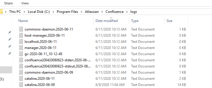

This is all i see under logs.
Sachin
June 11, 2020
Ah, that's catalina.out log files under installation dir, can you check the logs under confluence-home (c:/confluence/data/logs/atlassian-confluence.log) and open the atlassian-confluence.log file from todays timestamp when you faced the issue.

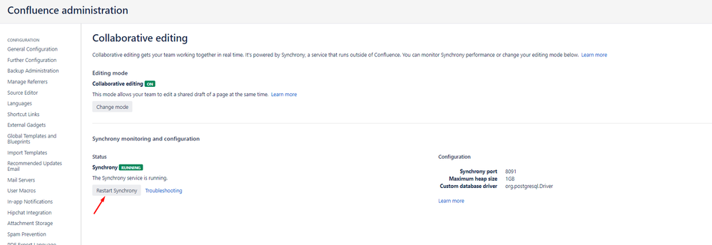

Sachin
June 11, 2020
Yeah, sometimes a server reboot or confluence restart would not kill the synchrony process, so try to follow below steps and see if it helps
Restart Synchrony
Navigate to Confluence Administration > General Configuration > Collaborative Editing and click on "Restart Synchrony".
Afterward, try to create a new page or edit an existing one and see if the issue is resolved. If not, proceed to the next step.
Justin Bleich
June 11, 2020
I am not seeing Confluence Administration > General Configuration > Collaborative Editing
Is this on the server or in the UI?
Sachin
June 11, 2020
This is on the UI, you need confluence Admin rights to goto the admin section.
Justin Bleich
June 11, 2020
The restart fixed it. Thank you for your assistance.
