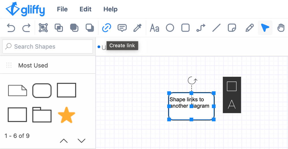

All Gliffy diagrams are stored as attachments on the page, so you can link from one object/shape/text in your diagram to another diagram by clicking link button in the navigation up top while a shape is selected or text is highlighted:
From there, you can either search for your diagram by name in the "Search" panel or select "Attachments" and chose from diagrams in the same space.
Let me know if you need more direction!

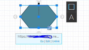

After I insert a document, I have the option to Go | Edit | Unlink, which looks promising.

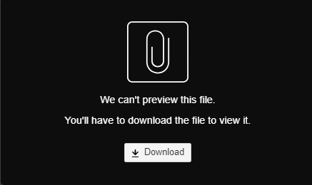

However, when I click the Go link, it opens up the Attachments page and there's a black box that says "We can't preview this file. You'll have to download the file to view it."
I click the download link and it gives me a file with no association type for me to review or do anything with it.

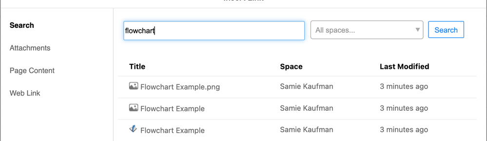

Thanks so much for all the detail, @brandon.torvick !! That's definitely not the ideal experience, but I am getting things to work on my side of things, so let me be a bit more specific.
I quickly created a diagram on a different page and called it "flowchart example" (original, I know). In order to have the link launch into the diagram viewer, you'll want to find the attachment option that includes the little Gliffy arrow icon. In this case that's the bottom one.
Using that option, when I click on the shape linked in my diagram, it launches me into the Gliffy viewer, a fullscreen version of the Flowchart Example diagram with /gliffy-confluence-fullscreen-viewer-launcher? as part of the URL.

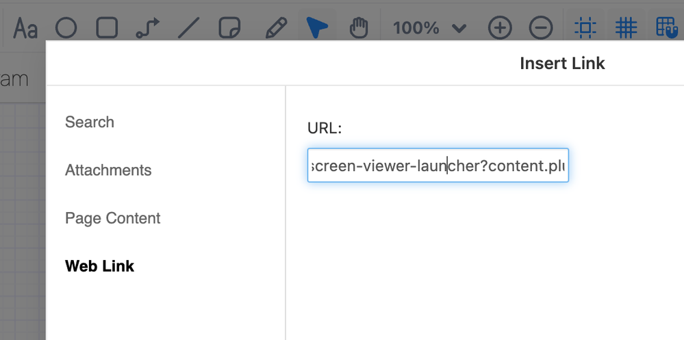

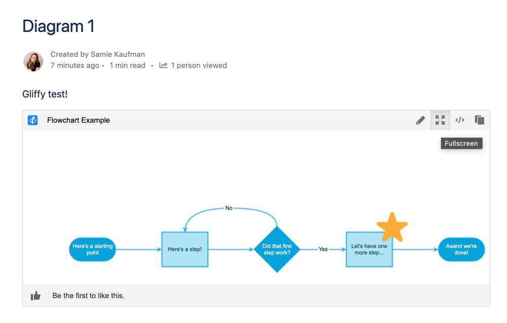

I also have a workaround for you. Instead of trying to search for the diagram you want to link to, open that diagram in the Gliffy viewer. You can do that by clicking the "fullscreen" button on the upper right of the diagram on your Confluence page:
This should launch the viewer, again with something like /gliffy-confluence-fullscreen-viewer in the URL. You can copy that entire link and use that in the "web link" option of the link modal:

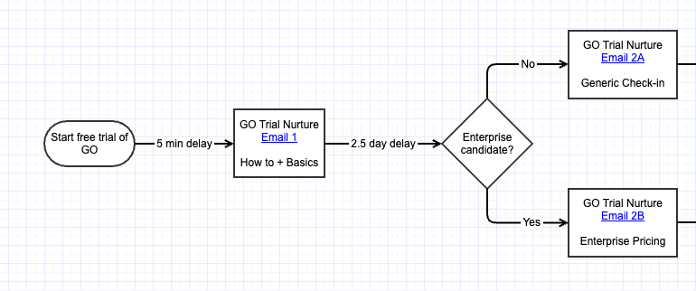

Links allows you to add a link to any online material, so you could absolutely add a shape or on-text link to any other web page (including Confluence pages) from one of your diagrams. So if you have a step in your business process that says "complete X form," you could use the Web Link option from above to link to an online version of that form. That way, your user could more easily work through the process without having to dig around for that form.
I'm part of Gliffy's marketing team, so as an example I have a email cadence/workflow for our free trial users diagrammed. I have links built to the copy for every email so that I can easily see the content of that email in the context of the workflow if I need to. It just saves me time. :) Here's a sneak peek:
