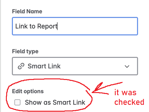

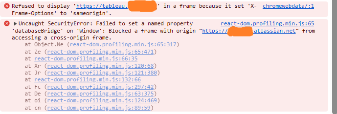

1. I didn't find any other links that failed to open except tableau links (for example google links open just fine) though tableau links are actually the main ones in this database (since it's a Report list).
2. When I open confluence database (before clicking links) there is one suspicious error shown error_url_not_supp.png
And after click on a link there is a few others

@Mariia Bov thanks for the image.
This looks like a tabelau error looking from the both error messages.This should be something that Tabelau vendor team needs to look for. I believe the vendor is Tempo. Their support page can be found here: https://tempo-io.atlassian.net/servicedesk/customer/portal/6/user/login?destination=portal%2F6%2Fgroup%2F1065%2Fcreate%2F1444
Use this image as a reference.
